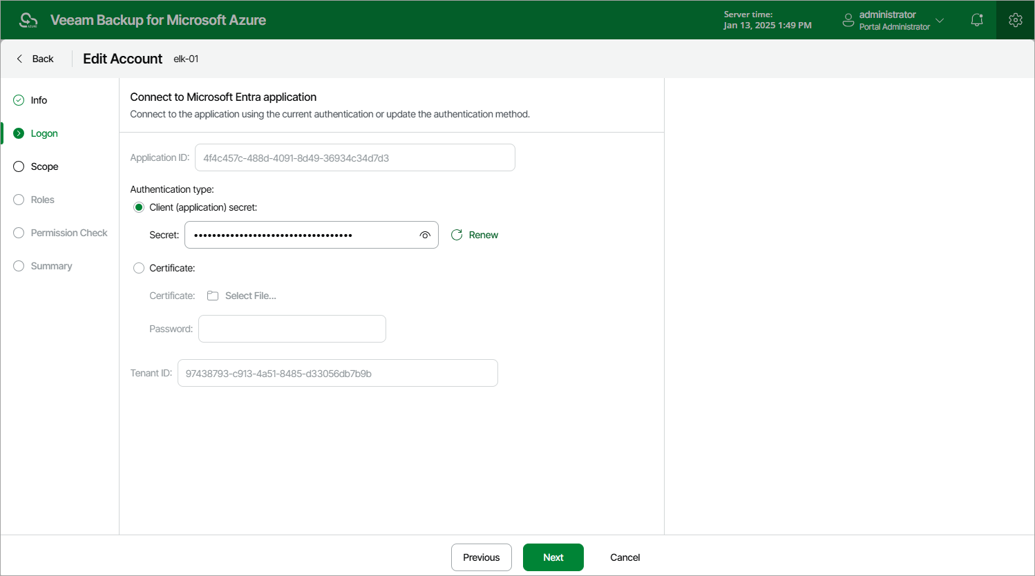

At the Logon step of the wizard, you can review the authentication method that is currently used to connect to the Microsoft Entra application with which the service account is associated. You can also renew a client secret that is about to expire, or associate a new Microsoft Entra application with the service account in case the application that was previously used is no longer available.

To renew a client secret that is about to expire, use either of the following options:
  • If you have selected the Specify existing service account option at the Type step of the Add Account wizard, create a new client secret in the specified Microsoft Entra application, enter the secret value in the Secret field and then click Next. To learn how to create client secrets, see Microsoft Docs.
  • If you have selected the Create service account automatically option at the Type step of the Add Account wizard, do the following:
  1. Click Renew next to the Secret field.
  2. In the Logon to Microsoft Azure window, click Copy Code to Clipboard and then click https://microsoft.com/devicelogin.
  3. On the Microsoft Azure device authentication page, do the following:
  1. Paste the code that you have copied and click Next.
  2. Select a Microsoft Azure account that will be used to access the Azure CLI. The account must be assigned either the User Access Administrator or the Owner role.
  1. Back to the Logon to Microsoft Azure window, check whether any errors occurred during the authentication process and click OK.
