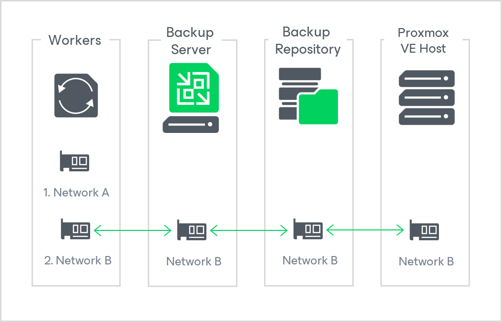

Example 1. Valid Configuration
In this example, the workers, the backup server, the repository and the Proxmox VE host are connected to Network B, while the workers are also connected to Network A that allows them to obtain updates from the internet. This configuration is valid since all backup infrastructure components are connected to the same network.
Network diagram 1

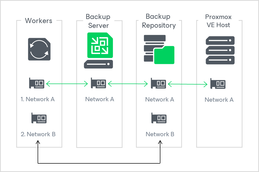

Example 2. Valid Configuration
In this example, the workers, the backup server, the repository and the Proxmox VE host are connected to Network A, while the workers and the backup repository are also connected to Network B that is configured as a preferred network to deliver traffic to the backup repository. This configuration is valid since all backup infrastructure components are connected to the same network.
The workers will be able to obtain updates from online Veeam repositories only if Network A is configured to allow inbound and outbound internet traffic.
Network diagram 2

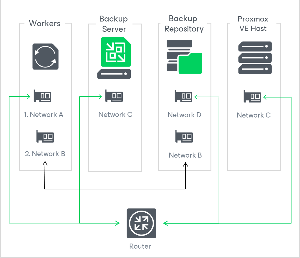

Example 3. Valid Configuration
In this example, the workers are connected to Network A using their first vNICs and to Network B that is configured as a preferred network to deliver traffic to the backup repository. Also, you have a router configured to forward traffic between networks A, C and D. This configuration is valid since the workers can use Network A to communicate with other backup infrastructure components though the router.
Network diagram 3

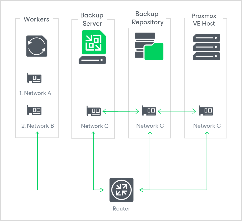

Example 4. Invalid Configuration
In this example, the workers are connected both to Network A using their first vNICs and to Network B using their second vNICs, while the backup server, the backup repository and the Proxmox VE host are connected to Network C. Also, you have a router configured to forward traffic between networks B and C. This configuration is invalid since the workers cannot use Network B to communicate with other backup infrastructure components through the router.
To make the configuration valid, do either of the following:
  • Change your network configuration to connect Network A to the router.
  • Add more vNICs to the workers. Then, connect these vNICs to Network C.
