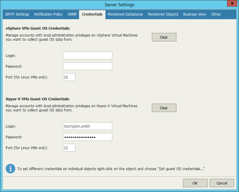

To specify account credentials for all VMs in the Microsoft Hyper-V infrastructure:
- Open Veeam ONE Monitor.
- On the toolbar, click Options and select Server Settings.
Alternatively, press the [CTRL+S] on the keyboard.
- In the Server Settings window, open the Credentials tab.
- In the Login and Password fields, specify credentials of an account that will be used to collect guest OS data from Microsoft Hyper-V VMs.
Credentials must be specified in the DOMAIN\Username format. For details on requirements to the account, see Connection to Microsoft Hyper-V VM Guest OS.
- [For Linux VMs] In the Port field, specify the port number to connect to guest OS.
- Click OK.
