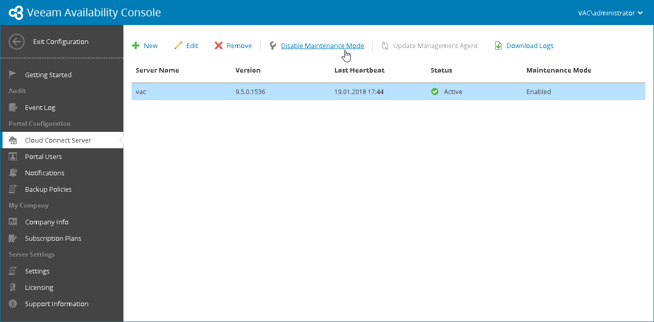

Enabling Maintenance Mode for Veeam Cloud Connect
To enable maintenance mode for Veeam Cloud Connect:
- Log in to Veeam Availability Console as a Portal Administrator.
For more details, see Accessing Veeam Availability Console.
- At the top right corner of the Veeam Availability Console window, click Configuration.
- In the configuration menu on the left, under Portal Configuration click Cloud Connect Server.
- Select the Veeam Cloud Connect server and click Enable Maintenance Mode.
- In the displayed dialog box, click Yes to confirm the operation.
Disabling Maintenance Mode for Veeam Cloud Connect
To disable maintenance mode for Veeam Cloud Connect:
- Select the Veeam Cloud Connect server and click Disable Maintenance Mode.
