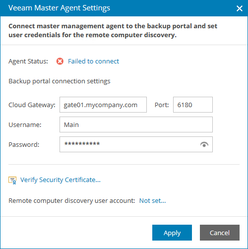

- In the icon tray, right-click the master agent icon and choose Agent Settings.
If the icon is hidden, display hidden icons, find Veeam.MBP.Agent.Configurator in the list of notification area icons, and choose to show the icon and notifications for it.
- In the Veeam Master Agent Settings window, specify settings that the agent must use to connect to Veeam Availability Console.
- In the Cloud Gateway field, type FQDN or IP address of a cloud gateway.
- In the Port field, specify the port on the cloud gateway that is used to transfer data to Veeam Availability Console.
- In the Username and Password fields, type user credentials of a Department Owner.
- In the Veeam Master Agent Settings window, click Apply.
- In the displayed window, click Yes to restart the management agent.
- Wait for the agent to connect to Veeam Availability Console.
When the agent connects to Veeam Availability Console, the status in the Veeam Master Agent Settings window will be displayed as Connected. The agent icon in the icon tray will turn blue.

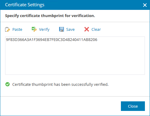

- [Recommended] Validate the certificate that will be used to secure traffic between the agent and Veeam Availability Console.
This step is optional but highly recommended, as it guarantees that the Veeam Availability Console server is what it claims to be, and the agent can securely communicate data to it. If at some stage you change the certificate for Veeam Cloud Connect and Veeam Availability Console, you can update the thumbprint as described in How to Change Certificate Thumbprint for Management Agents. |
- Click the Verify Security Certificate link.
- In the Specify certificate thumbprint for verification field, paste the thumbprint of a certificate that is installed on the Veeam Availability Console and Veeam Cloud Connect servers.
The thumbprint is used to verify the authenticity of the certificate installed on the Veeam Availability Console and Veeam Cloud Connect servers. For more details on the certificate, see Managing TLS Certificates.
- Click Verify to verify the certificate.
- Click Save.
- Click Close.
