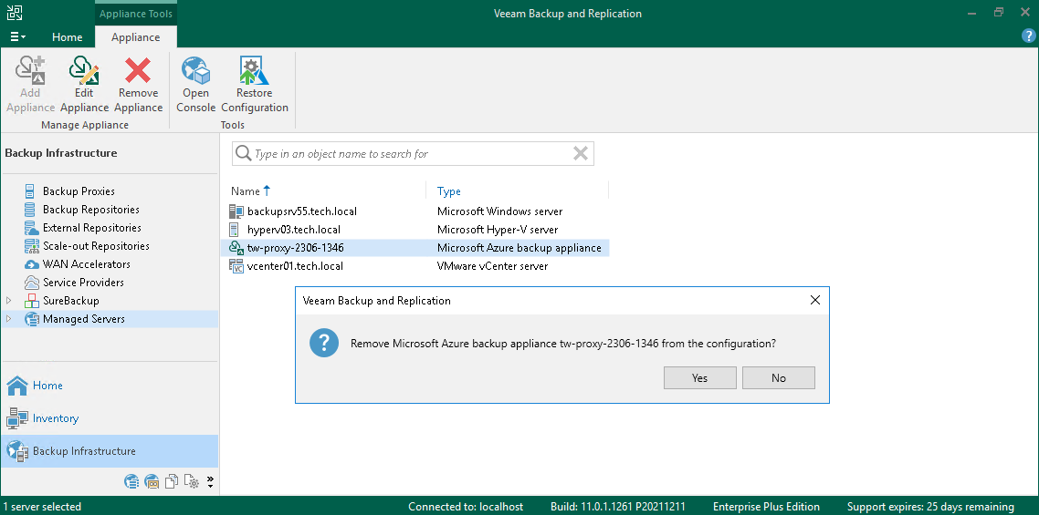

To remove an appliance from the Veeam Backup & Replication infrastructure:
- Open the Backup Infrastructure view.
- In the inventory pane, select Managed Servers.
- In the working area, select the appliance that you want to remove, and click Remove Appliance on the ribbon. Alternatively, right-click the appliance and select Remove.
- In the opened window, click Yes. If you see the Delete cloud resources associated with the backup appliance from infrastructure check box, make sure that it is not selected.

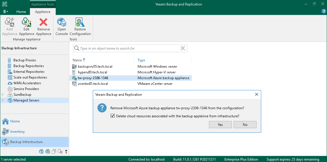

To remove an appliance from both the Veeam Backup & Replication and Microsoft Azure infrastructures:
- In the opened window, select the Delete cloud resources associated with the backup appliance from infrastructure check box and click Yes.
