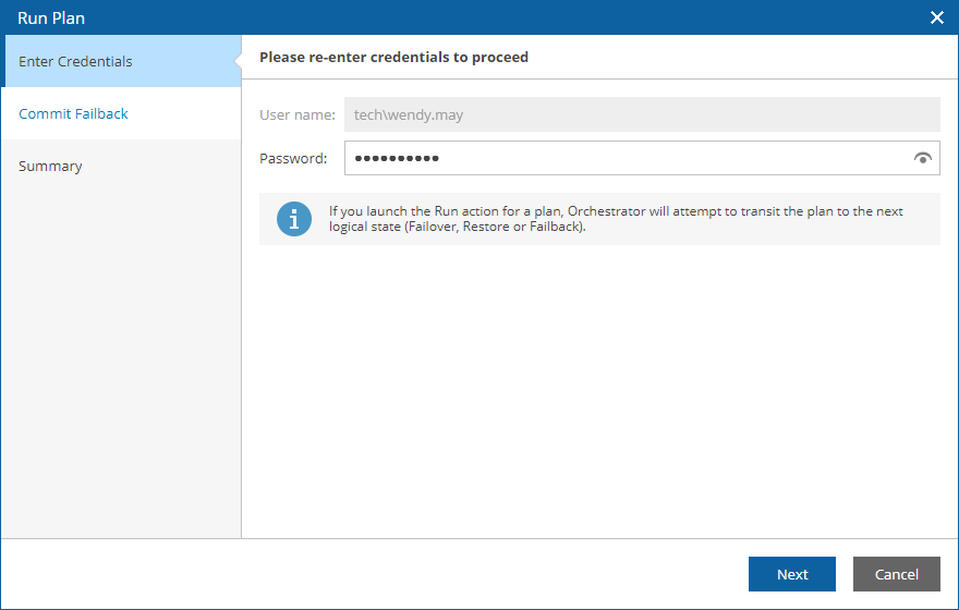

  1. Complete the Run Plan wizard:
  1. For security purposes, at the Enter Credentials step, retype the Orchestrator Administrator or Plan Operator password.

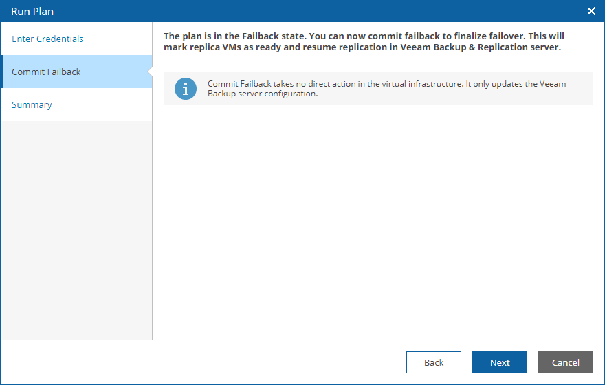

  1. At the Commit Failback step, review the description of the commit failback process.
