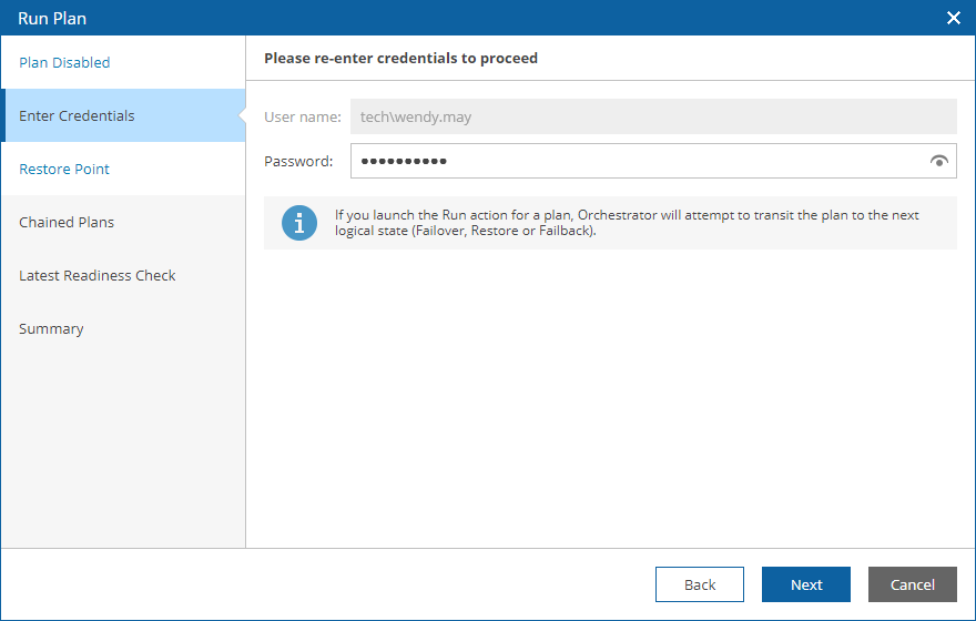

  1. For security purposes, at the Enter Credentials step, retype the Orchestrator Administrator or Plan Operator password.
Running Failover

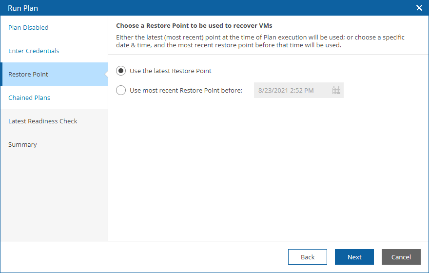

  1. At the Restore Point step, choose a restore point that will be used to recover VM replicas.
Running Failover

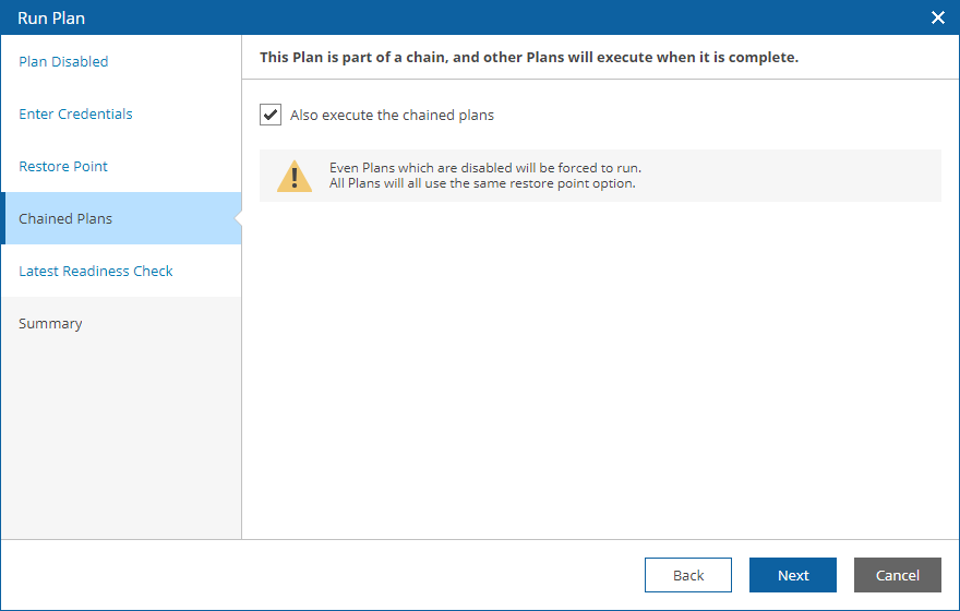

  1. [This step applies only if you have any other orchestration plans scheduled to run after the plan completes]
At the Chained Plans step, select the Also execute the chained plans check box to proceed to execution of subsequent plans after the current plan enters the FAILOVER state.
Running Failover

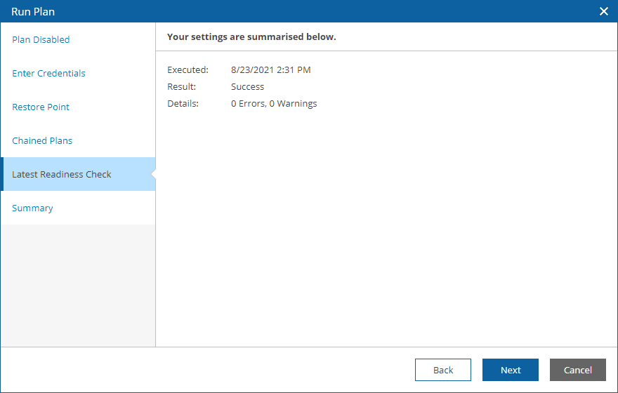

  1. At the Latest Readiness Check step, review the results of the most recent readiness check run for the plan to make sure the plan can complete successfully.
Running Failover
