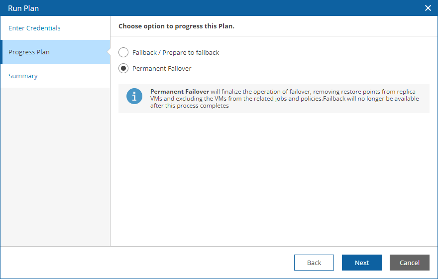

  1. Complete the Run Plan wizard:
  1. For security purposes, at the Enter Credentials step, retype the Orchestrator Administrator or Plan Operator password.
Running Permanent Failover
  1. At the Progress Plan step, select the Permanent Failover option.
  1. At the Summary step, review configuration information and click Finish.
Failback will no longer be an option once the permanent failover process is over.
