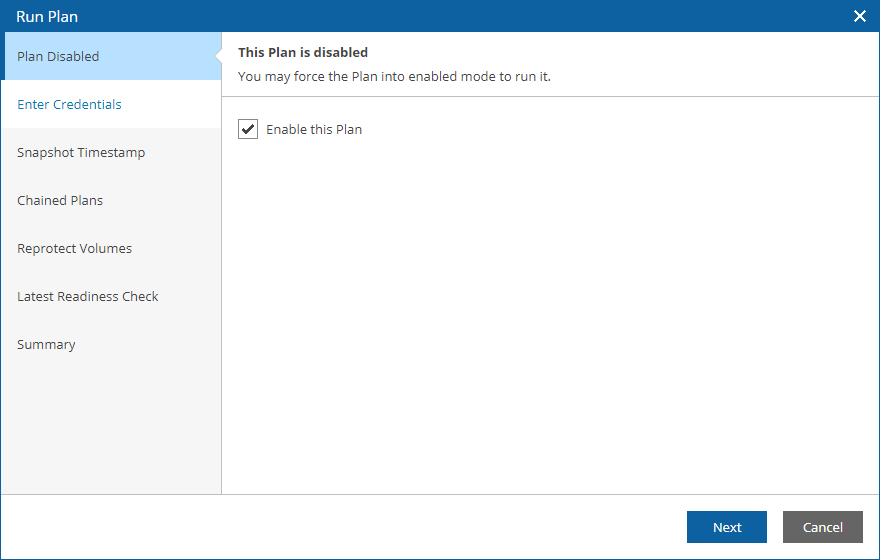

  1. [This step applies only if you have not enabled the plan before running it]
At the Plan Disabled step, select the Enable this Plan check box to enable the plan. You will not be able to proceed with the wizard unless you select the check box.

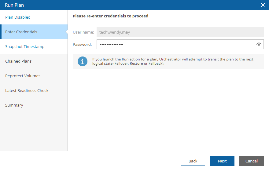

  1. For security purposes, at the Enter Credentials step, retype the Orchestrator Administrator or Plan Operator password.

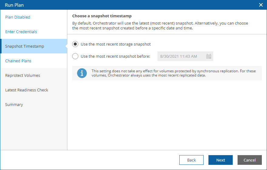

  1. At the Snapshot Timestamp step, select a snapshot that will be used to recover VMs.
To choose target storage systems to be used to recover VMs, Orchestrator will analyze settings specified during the configuration of storage recovery locations. For more information, see How Orchestrator Processes Resources.
This setting applies only to volumes protected by asynchronous replication. If a volume is protected by synchronous replication, Orchestrator will always use the most recent replicated data. This is a limitation of the synchronous SnapMirror technology.

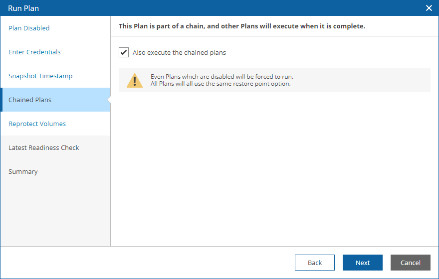

  1. [This step applies only if you have any other orchestration plans scheduled to run after the plan completes]
At the Chained Plans step, select the Also execute the chained plans check box to proceed to execution of subsequent plans after the current plan enters the FAILOVER state.

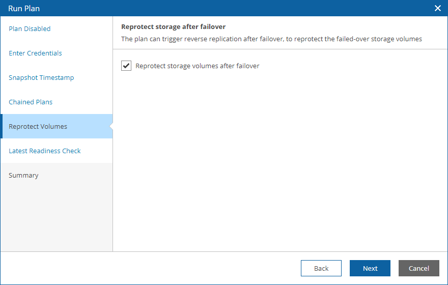

  1. At the Reprotect Volumes step, choose whether you want Orchestrator to trigger reverse replication to reprotect volumes included in the plan. This option can be useful if you plan to fail back to the production location.
If you select the Reprotect storage volumes after failover check box, Orchestrator will add the Protect Storage Volumes step to the list of plan steps. This step will resynchronize the data protection relationship in the reverse direction as soon as the storage failover process completes.
When running the Protect Storage Volumes step, Orchestrator only triggers the reprotect operation and reports whether the step itself started successfully — Orchestrator does not check whether the operation of resynchronizing the relationship in the reverse direction completes successfully.
For more information on what a reprotect operation does, see the NetApp ONTAP Documentation Center.
Running Storage Failover
The Protect Storage Volumes step will interfere with the existing jobs that use storage snapshots in Veeam Backup & Replication. Since the step reverses the source and destination roles of SnapMirror relationships, these jobs will no longer function properly after the storage failover process completes.
To work around the issue, add the Veeam Job Actions step to the list of pre-plan steps before running the plan. To disable a job, specify its name when configuring the step parameters.

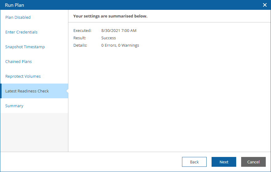

  1. At the Latest Readiness Check step, review the results of the most recent readiness check run for the plan to make sure the plan can complete successfully.
  1. At the Summary step, review configuration information and click Finish.
