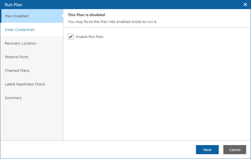

  1. [This step applies only if you have not enabled the plan before running it]
At the Plan Disabled step, select the Enable this Plan check box to enable the plan. You will not be able to proceed with the wizard unless you select the check box.

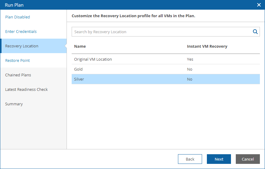

  1. At the Recovery Location step, select a location to which VM groups included in the plan will be restored.
For a recovery location to be displayed in the list of available recovery locations, it must be created and included into the list of plan components available for the scope, as described in section Managing Recovery Locations.
Running Restore
If the selected recovery location includes multiple hosts, datastores and networks, Orchestrator will use the round-robin algorithm to restore VMs added to the plan. For more information, see How Orchestrator Processes Resources.

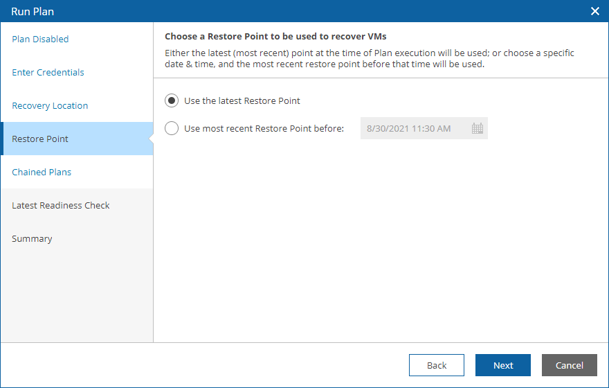

  1. At the Restore Point step, choose a restore point that will be used to recover VMs.
Recovering data from the archive tier is not supported. If you select the Use most recent Restore Point before option, make sure to choose a restore point that is stored in either the capacity or the performance tier. For more information on Veeam Backup & Replication tiering options, see the Veeam Backup & Replication User Guide, section Scale-Out Backup Repository.
