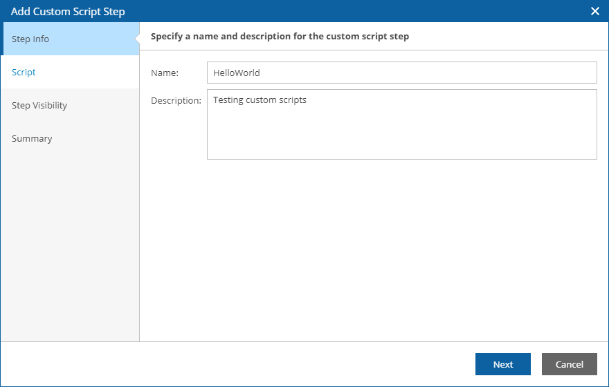

  5. Complete the Add Custom Script Step wizard:
  1. At the Step Info step, enter a name for the custom script step and to provide a description for future reference. The maximum length of the step name is 64 characters; the following characters are not supported: * : / \ ? " < > | .
