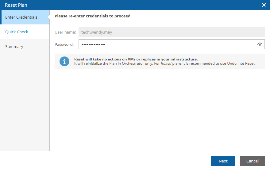

  1. For security purposes, at the Enter Credentials step, retype the Orchestrator Administrator, Plan Author or Plan Operator password.
Resetting Replica Plan

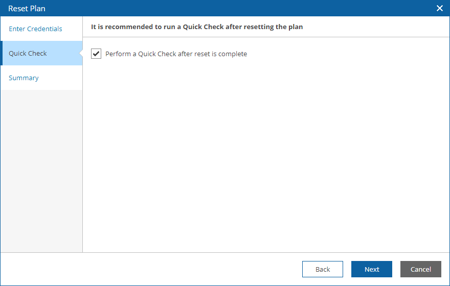

  1. At the Quick Check step, select the Perform a Quick Check after reset is complete check box to run a readiness check to confirm that the changes are valid.
