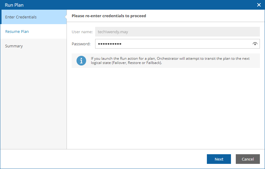

  1. For security purposes, at the Enter Credentials step, retype the Orchestrator Administrator or Plan Operator password.

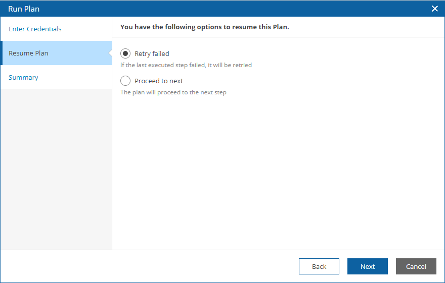

  1. At the Resume Plan step, select an option to resume plan execution.
Choose whether you want to proceed with plan execution from the next plan step or to retry the failed step.
