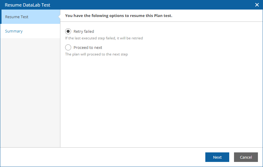

  1. Complete the Resume DataLab Test wizard:
  1. At the Resume Test step, select an option to resume test execution.
Choose whether you want to proceed with test execution from the next plan step or to retry the failed step.
Running Halted Storage Plan
  1. At the Summary step, review configuration information and click Finish. The testing process will be started.
