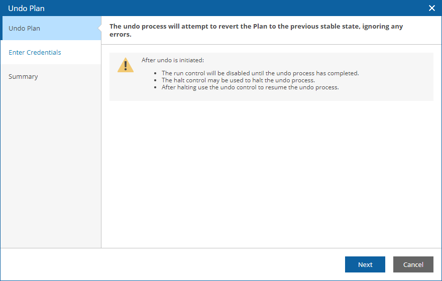

  1. Complete the Undo Plan wizard:
  1. At the Undo Plan step, review the description of the undo operation.
Undoing Failover
  1. For security purposes, at the Enter Credentials step, retype the Orchestrator Administrator or Plan Operator password.
Undoing Failover
  1. At the Summary step, review configuration information and click Finish.
