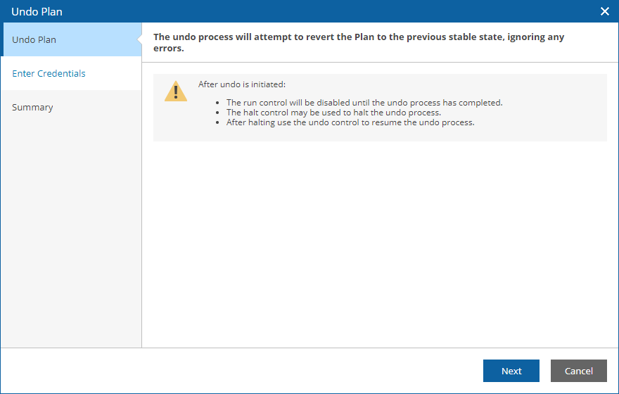

  1. Complete the Undo Plan wizard:
  1. At the Undo Plan step, review the description of the undo operation.
