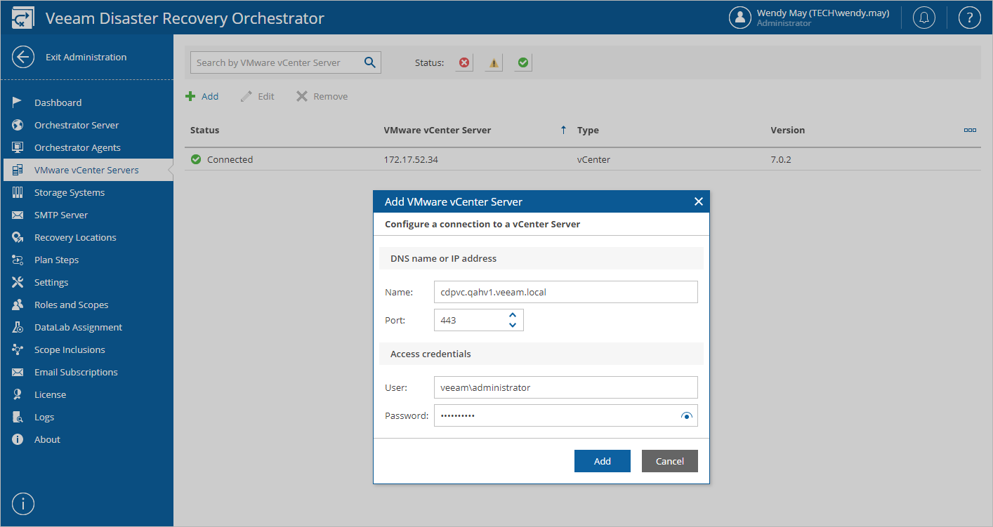

  4. In the Add VMware vCenter Server window:
  1. In the Name field, enter a DNS name or an IP address of the vCenter Server that will be connected to the Orchestrator server.
  2. In the User and Password fields, specify credentials of a user account for connecting to the server. The user name must be specified in the DOMAIN\USERNAME format.
  3. If required, you can change the port number used for communication with the server.
  4. Click Add.
If an untrusted security certificate is installed on the vCenter Server, you will get a security warning. You can view the certificate and click Remember and Continue — in this case, Orchestrator will remember the certificate thumbprint and will further trust the certificate when connecting to the server. Otherwise, you will not be able to add the server.
