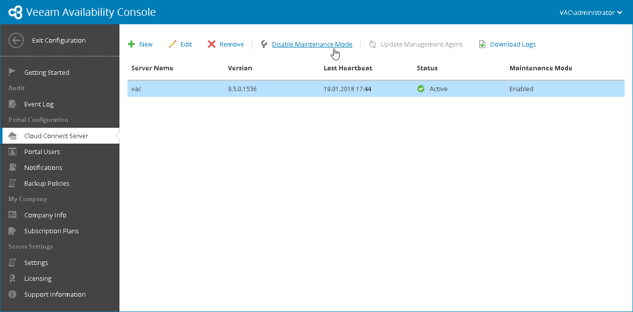

Enabling Maintenance Mode for Veeam Cloud Connect
To enable maintenance mode for Veeam Cloud Connect:
  1. Log in to Veeam Availability Console as a Portal Administrator.
For more details, see Accessing Veeam Availability Console.
  1. At the top right corner of the Veeam Availability Console window, click Configuration.
  2. In the configuration menu on the left, under Portal Configuration click Cloud Connect Server.
  3. Select the Veeam Cloud Connect server and click Enable Maintenance Mode.
Enabling and Disabling Maintenance Mode for Veeam Cloud Connect
  1. In the displayed dialog box, click Yes to confirm the operation.
To disable maintenance mode for Veeam Cloud Connect:
  3. Select the Veeam Cloud Connect server and click Disable Maintenance Mode.
