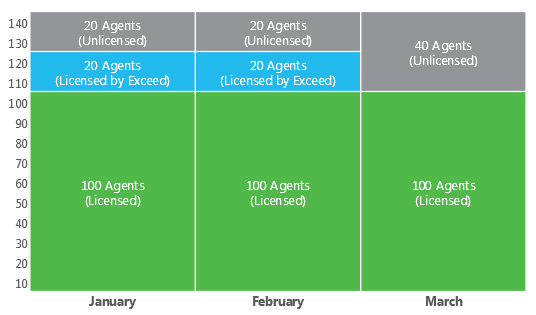

Example
Consider the following example.
Your Rental license covers 100 Veeam backup agents. The exceed grace period for the license is 2 months.
At the beginning of January the number of Veeam backup agents is 140. Within the first 2 months (January and February), Veeam Availability Console will manage 100 + 20 Veeam backup agents that were registered first (license limit + 20% allowed increase). 20 Veeam backup agents that were registered last will not be managed. If the license is not updated until the end of the grace period, and the license pool is not increased, in March Veeam Availability Console will change the status of 40 Veeam backup agents that exceed the license limit to Unlicensed.

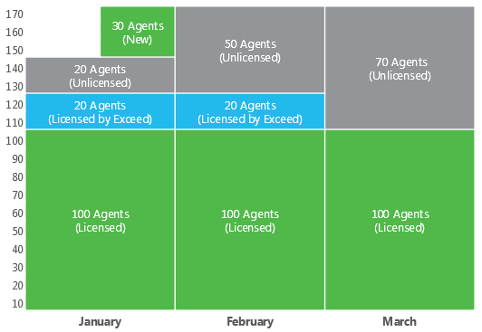

Consider the same example with New Veeam backup agents.
In the middle of January, 30 new Veeam backup agents are registered in Veeam Availability Console. Veeam Availability Console will manage these Veeam backup agents until the end of the month. If the license is not updated, and the license pool is not increased, in February Veeam Availability Console will change the license statuses as follows:
- The license status of Veeam backup agents that exceeded the license limit in January will be kept as Licensed by Exceed.
- 30 Veeam backup agents that were registered in the middle of January will obtain the Unlicensed status.
If the license is not updated until the end of the grace period, and the license pool is not increased, in March Veeam Availability Console will change the status of 70 Veeam backup agents that exceed the license limit to Unlicensed. If a new license covering a larger number of licenses is installed, the licenses will be assigned to Veeam backup agents that were registered first.
