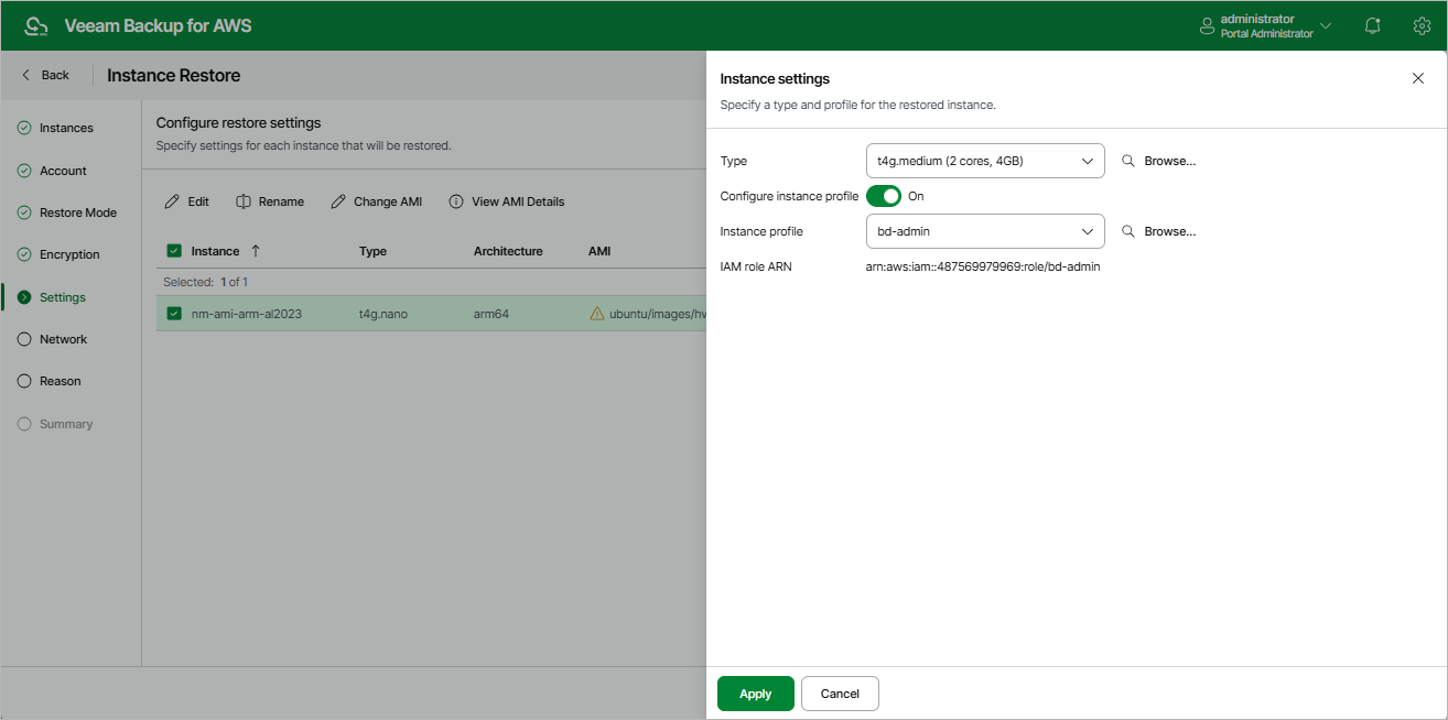

At the Settings step of the wizard, do the following for each EC2 instance added to the restore session:
  1. Select the EC2 instance.
  2. If you want to specify a new name for the restored EC2 instance, click Rename.
  3. If you want to configure type and profile settings for the restored EC2 instance, click Edit. For the list of all existing instance types, see AWS Documentation.
To attach an instance profile to the restored EC2 instance or to replace the original instance profile that is already attached to the instance, set the Configure instance profile toggle to On and then select the necessary profile from the Instance profile drop-down list. If you set the Instance profile toggle to Off, the instance will be restored without any profile attached. For more information on instance profiles, see AWS Documentation.
