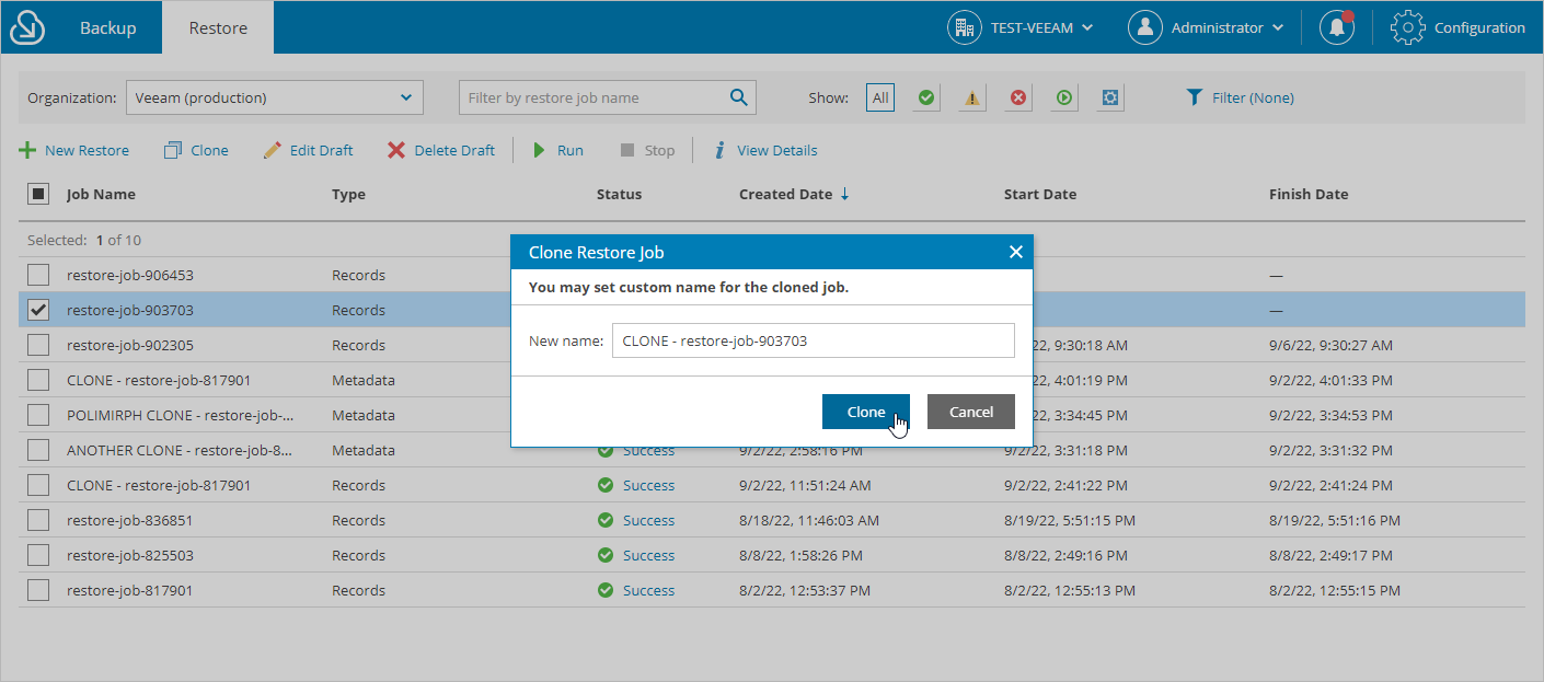

You can clone a restore job if you want to launch it again or to create a new job based on the settings of the existing one.
You cannot clone a running restore job.
To clone a restore job:
  1. Navigate to the Restore tab.
  2. From the Organization drop-down list, select a Salesforce organization for which the restore job has been created.
  3. Select the necessary restore job.
You can filter restore jobs displayed on the Restore tab by using the icons in the Show field at the top of the list. If you set a filter, the settings apply to all companies and do not change during the current user session. That is why if you do not see the necessary job in the list, make sure that the All filter is set.
  1. Click Clone.
  2. In the Clone Restore Job window, specify a name for the new job, and click Clone.
After you clone the restore job, you can edit settings of the new draft.
Cloning Restore Job

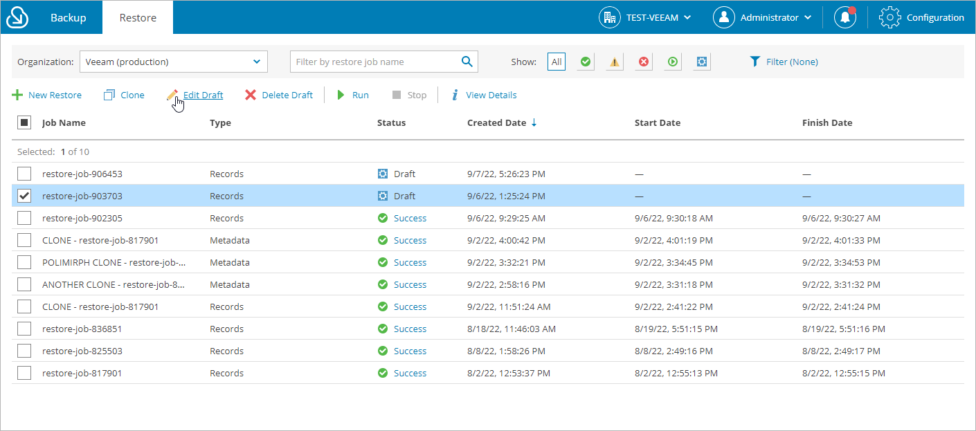

Editing Restore Jobs
You can edit restore jobs created in Veeam Backup for Salesforce that were not launched yet. For example, you may want to modify some settings specified in a restore job, change the chosen object and fields, and so on.
To edit restore job settings, do the following:
  1. Click Edit Draft. The restore job wizard will open.
  2. Edit the job settings as described in sections Restoring Records, Restoring Field Values, Restoring Files or Restoring Metadata.
Editing Restore Job
