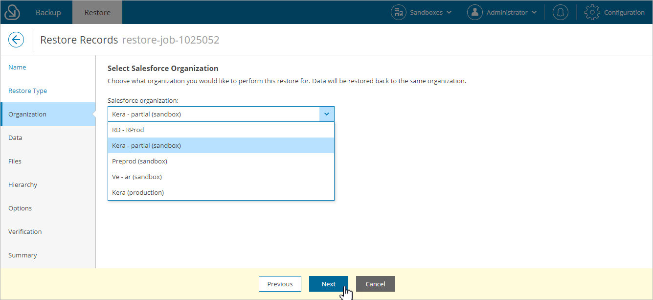

Step 4. Select Organization
At the Organization step of the wizard, select a Salesforce organization to which you want to restore records. For a Salesforce organization to be displayed in the list, it must belong to the company specified at step 1.
