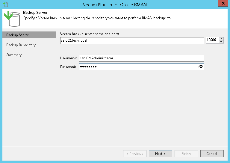

  2. At the Backup Server step of the wizard, specify the DNS name of the Veeam Backup & Replication server and credentials that will be used to connect to the server. The specified account must have the local Administrator permissions on the Veeam Backup & Replication server.

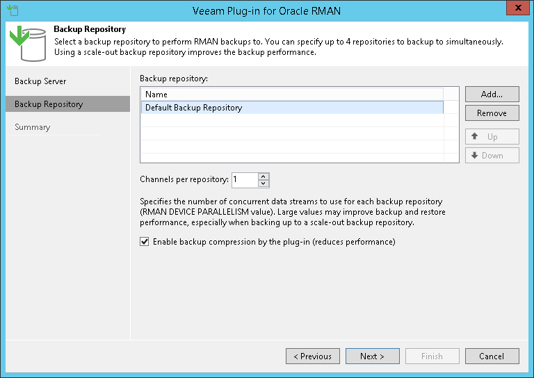

  1. At the Backup Repository step of the wizard:
  1. Click Add and select the required repository. For Oracle Database Standard Edition, you can select only one repository. If you want to use the Oracle RMAN Backup Duplexing functionality, you can select up to four repositories. The copies of backups will be sent to all selected repositories.
You must allow access to Veeam backup repositories that you plan to use. Also, the encryption on the repository must be disabled. To learn how to configure access and encryption on repositories, see Access and Encryption Settings on Repositories.
  1. If you want to use another repository, select the repository from the list and click Remove. Then, you can add another repository
  2. At the Channels per repository field, specify the number of allowed parallel data streams for each repository.
  3. If you want to enable Veeam Plug-in compression, select the Enable backup compression by the plug-in check box.
Note that if you use Veeam Plug-in compression in combination with Oracle RMAN integrated compression (BACKUP AS COMPRESSED commands), it can slow down processing.
  1. Click Next.
