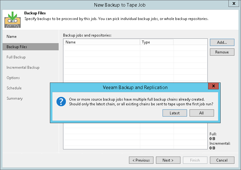

At the Backup Files step of the wizard, select backups that you want to write to tape with the created job.
Click Add and select the necessary backups. You can choose backups from the following sources:

On the first run, the tape job can copy all restore points or only the latest backup chain. This option is useful if the source backup job or the source backup repository has several backup chains. The backup chain here means a full backup file plus a set of incremental backup files following it.
To select what backup files you want to archive:
- Click Add and select Backup jobs or Backup repositories.
- Select the necessary backup job or repository you want to add to the tape job.
- Veeam Backup & Replication will display a warning informing about backup chain options. Click Latest to archive only the latest backup chain to tape. This options lets you have only the latest restore points written to tape and use less tape for data archiving. Click All to archive all available backup files.
This option selects what backup chain will be copied on the first run of the job. You can instruct the job to copy only the latest backup chain on every tape job run. This option is available in the advanced settings of the job. For more information, see Advanced Settings.
