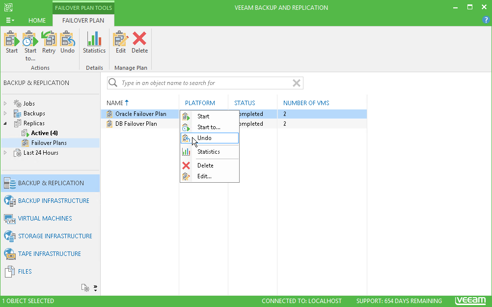

    To undo failover by a failover plan:
    1. Open the Backup & Replication view.
    2. Expand the Replicas node.
    3. Select Failover Plans.
    4. In the working area, right-click the failover plan and select Undo.
    5. In the displayed dialog box, click Yes to confirm the operation.
