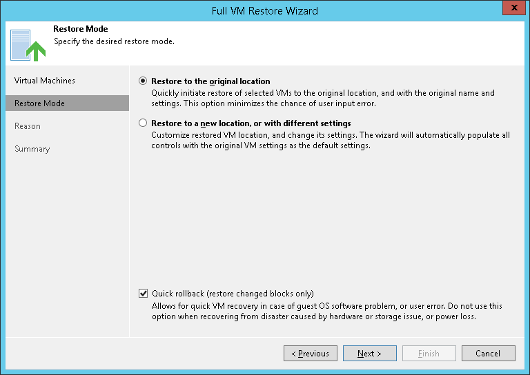

    When you restore a full VM to the original location, you can instruct Veeam Backup & Replication to perform quick rollback — incremental data restore. Instead of restoring an entire VM from a backup file, Veeam Backup & Replication will recover only those data blocks that are necessary to revert the VM to an earlier point in time. Quick rollback significantly reduces the recovery time and has little impact on the production environment.
    For quick rollback, Veeam Backup & Replication uses the changed block tracking technology. Veeam Backup & Replication gets information about the current VM state and compares it with the CBT information in the backup file. This way, Veeam Backup & Replication detects what data blocks must be transported back to the production volume to rebuild the VM to the necessary point in time.
    It is recommended that you use quick rollback if you restore a VM after a problem that has occurred at the level of the VM guest OS — for example, there has been an application error or a user has accidentally deleted a file on the VM guest OS. Do not use quick rollback if the problem has occurred at the VM hardware level, storage level or due to a power loss.

    • VM must be restored to its original location.
    • The backup file from which you plan to restore a VM must be created with the Use changed block tracking data option enabled.
