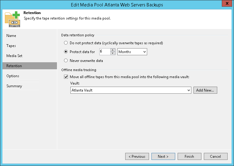

To set the automatic placing of tapes to a vault, you need to configure the media pool where the target tapes are recorded. To configure a simple media pool:
  1. Open the Tape Infrastructure view and select the Media Pools node.
  2. Select the media pool you want to customize.
  3. Click Edit Media Pool on the ribbon. Alternatively, you can right-click the media pool and select Properties.
  4. Go to the Retention step of the Edit Media Pool wizard: in the Offline media tracking field, select Move all offline tapes from this media pool into the following media vault. Select the needed vault from the drop-down list.
Note that moving tapes to a vault automatically will not be available if you select Do not protect data (cyclically overwrite tapes as required) option as a data retention policy.

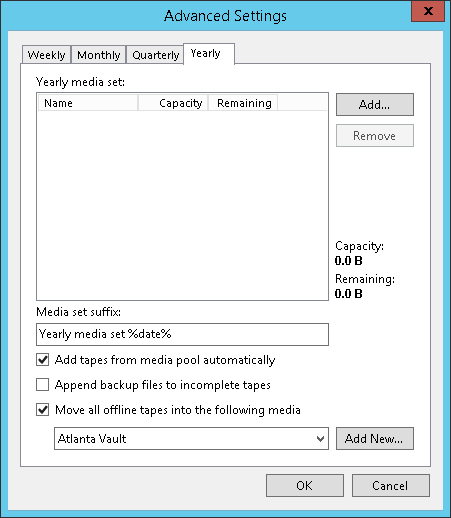

Vaulting of GFS tapes is set for media sets individually. To change a media set configuration:
  2. Select the GFS media pool you want to customize.
  4. Go to the GFS Media Set step of the Edit Media Pool wizard and click Advanced. Select a tab with the needed media set and select Move all offline tapes into the following media vault. Select the needed vault from the drop-down list.
