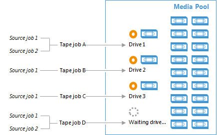

Processing Tape Jobs Simultaneously
When you process tape jobs parallely, the media pool assigns a drive to each running tape job. The media pool can use the predefined maximum number of drives and process the equal number of tape jobs simultaneously. For example, if you set 3 drives as the maximum, you can process up to 3 tape jobs at the same time. If you have more jobs running at the same time, they are queued. When one of the jobs finishes and releases its drive, the first queued job takes the drive.
This option is available for backup to tape and file to tape jobs.
For example:
The tape jobs start, and jobs A, B and C occupy 3 drives to write data to tape. The Tape job D is queued and waits. When one of the jobs finishes and releases its drive, the Tape job D takes the drive and starts writing data.

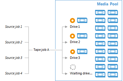

Processing Backup Chains Simultaneously
When you select processing backup chains paralelly, the media pool processes several primary jobs simultaneously. If the primary jobs produce per-VM backups, the media pool processes several per-VM backup chains simultaneously. For more information about per-VM backup files, see Per-VM Backup Files
This option is available for backup to tape jobs only.
For example:
  • You set the maximum number of drives to 3.
  • Tape job A has 4 primary jobs.
Tape job A starts, and occupies 3 drives to process 3 primary jobs. The fourth primary job is queued and waits. When one of the drives is released, the fourth primary job takes the drive and starts writing data.
If another tape job starts, it will be queued and wait until Tape job A finishes.

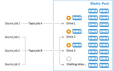

If a tape job has only 1 primary job, it is processed as 1 source.
For example:
  • Tape job A has 1 primary job; Tape job B has 3 primary jobs. Both tape jobs start at the same time.
Tape job A occupies Drive 1. Tape job B occupies 2 other available drives and processes 2 primary jobs. Tape job A finishes and releases Drive 1, the third primary job from the Tape job B occupies Drive 1.
