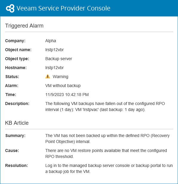

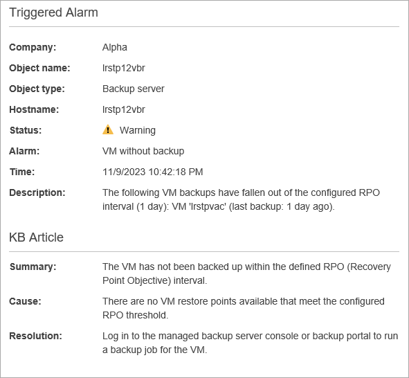

The following image illustrates an email notification with alarm details.
Alarm Email Notification

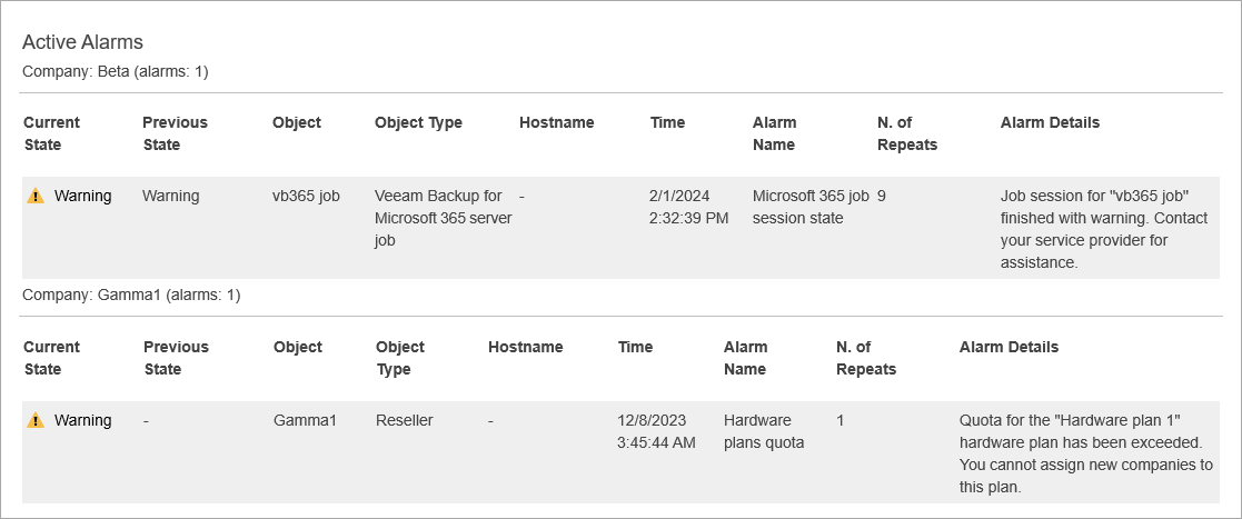

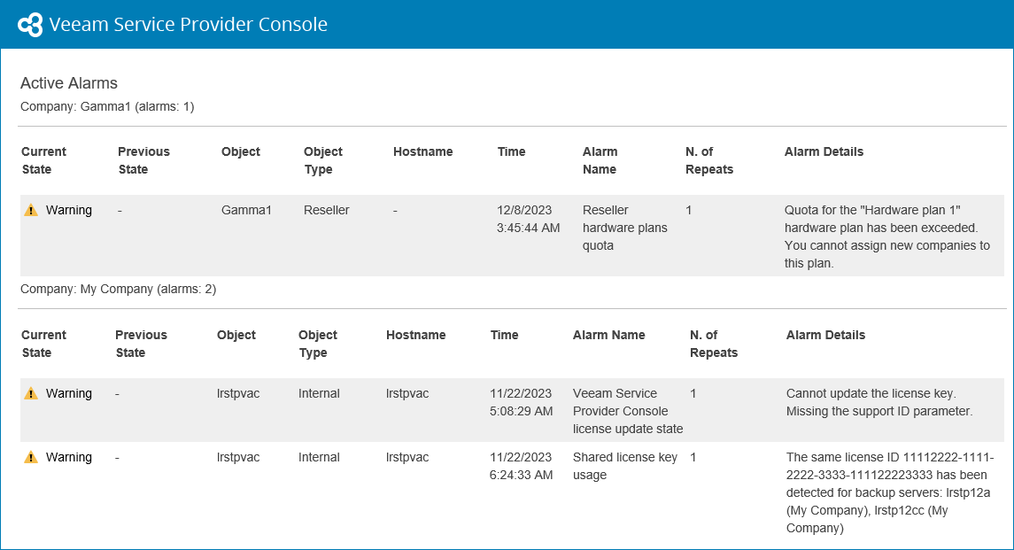

Daily Alarm Email Notification
