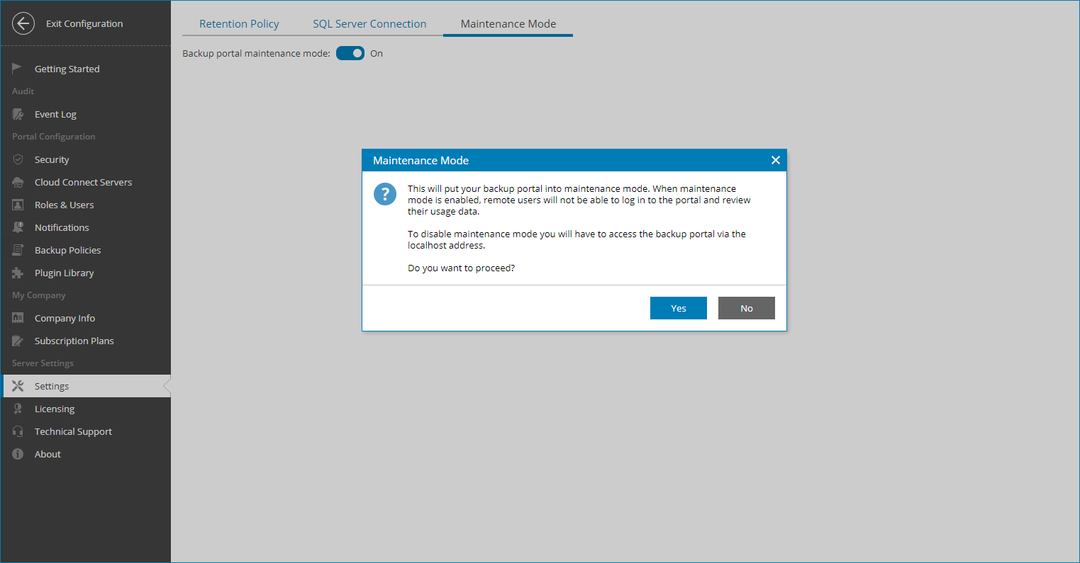

To enable maintenance mode for Veeam Service Provider Console:
  2. In the configuration menu on the left, click Settings.
  3. At the top, open the Maintenance Mode tab.
  4. Set the Backup portal maintenance mode toggle to On.
  5. In the Maintenance Mode window, click Yes.
Enable Maintenance Mode
