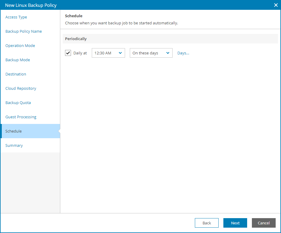

Workstation Backup Schedule
At the Schedule step of the wizard, specify the schedule according to which backup must be performed.
  1. Select the Daily at check box and use the fields on the right to specify time and days when the backup job must start:
If this check box is not selected, you will have to start the backup job manually to create backup.
  1. If you have selected the On these days option, click the Days button and clear check boxes for the days when the job must not start.
Specify Backup Schedule

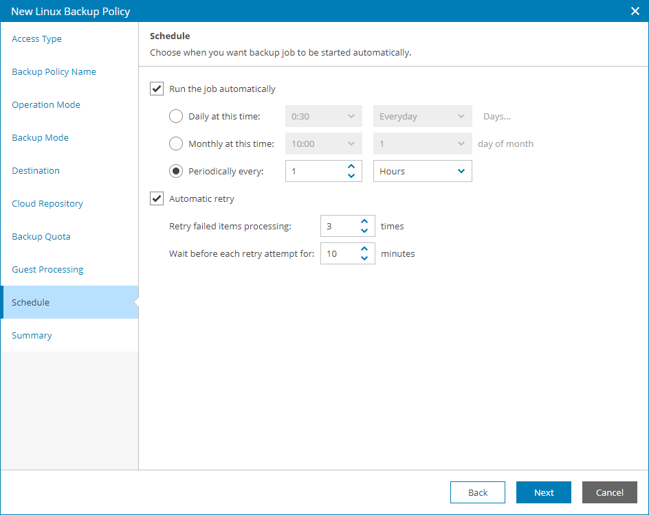

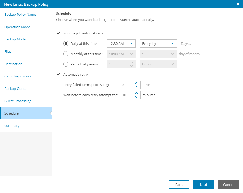

Server Backup Schedule
At the Schedule step of the wizard, select to run the backup job manually or schedule the job to run on a regular basis.
To specify the job schedule:
  1. Select the Run the job automatically check box.
  1. Define scheduling settings for the job:
A repeatedly run job always starts counting defined intervals from 12:00 AM. For example, if you configure to run a job with a 4-hour interval, the job will start at 12:00 AM, 4:00 AM, 8:00 AM, 12:00 PM, 4:00 PM and so on.
  1. In the Automatic retry section, define whether Veeam backup agent must attempt to run the backup job again if the job fails for some reason. Type the number of attempts to run the job and define time intervals between them.
