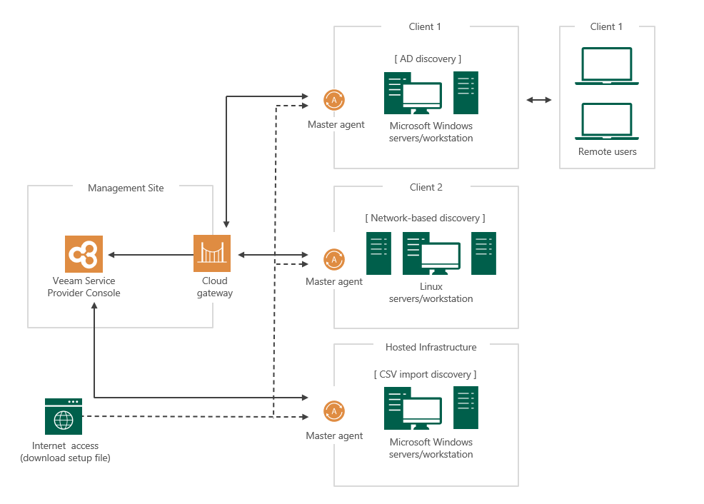

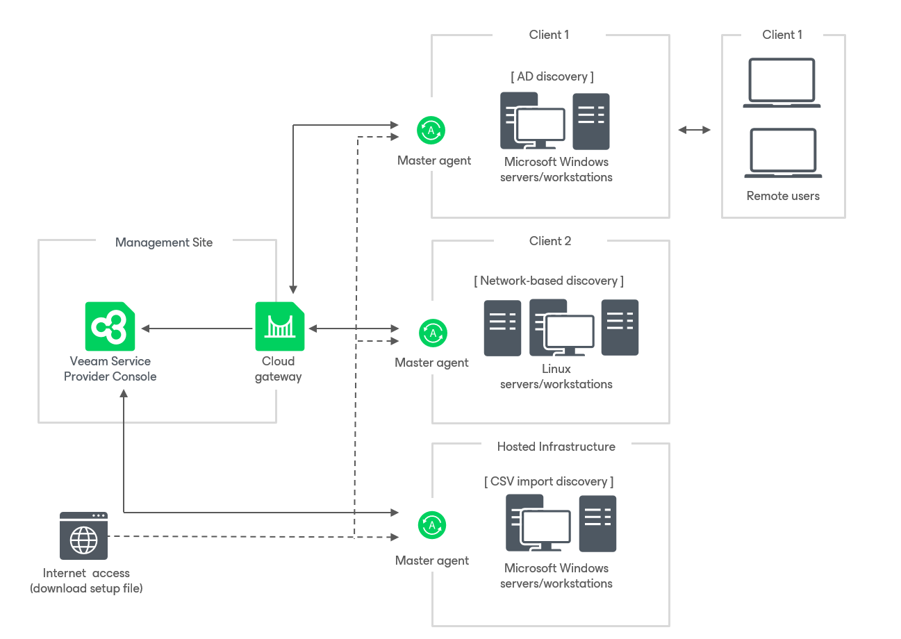

The following diagram provides a high-level pictorial overview of the discovery-based installation method.
Discovery-Based Installation
Discovery of Client and Hosted Computers
Discovery of client and hosted computers runs as follows:
  1. A backup administrator sets up a master agent in a client or hosted location, configures a discovery rule and initiates the discovery process.
The discovery rule describes settings required to perform discovery and (optionally) installation of Veeam backup agents on discovered computers. Discovery rule prescribes what master agent will be used for discovery, what client or hosted computers must be scanned, what account will be used to connect to these computers, whether Veeam backup agents must be installed on discovered computers, and so on.
The discovery rule can use one of the following discovery methods: network-based discovery, Active Directory discovery or import-based discovery.
  1. The master agent obtains from Veeam Service Provider Console discovery settings specified in the discovery rule. The agent connects to client or hosted computers under the specified account, collects configuration information about each scanned computer through WMI (for Windows computers) or SSH (for Linux computers), and communicates information about discovery results to Veeam Service Provider Console.
Information collected from discovered computers includes details on the computer type, platform, host name, guest OS, IP address, MAC address, available applications and information about Veeam products (their presence on the machine, product version and license installed).
  1. If the discovery rule is configured to install Veeam backup agents on discovered computers and set up a backup job, the master agent initiates these tasks after discovery:
  1. The master agent downloads the Veeam backup agent setup file from the Veeam Installation Server (over the Internet), and uploads this file to discovered computers.
  2. The master agent downloads the Veeam Service Provider Console management agent setup file from the Veeam Service Provider Console server, uploads this file to discovered computers, triggers management agent installation, and configures management agents to communicate with Veeam Service Provider Console.
  3. Veeam Service Provider Console management agents on the discovered computers trigger installation of Veeam backup agents.
  4. When installation completes, management agents activate Veeam backup agents.
  5. If a backup job must be set up as part of the installation procedure, management agents apply a backup policy.
