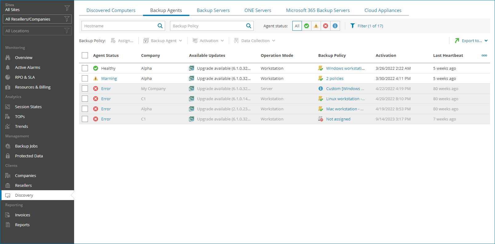

  2. Open the Backup Agents tab.
  3. To narrow down the list of managed Veeam backup agents, you can apply the following filters:
  • Hostname — limit the list of Veeam backup agents by the name of protected computer.
  • Backup Policy — limit the list of Veeam backup agents by the name of a backup policy.
  • Agent status — limit the list of Veeam backup agents by the Veeam Service Provider Console management agent status (Healthy, Warning, Error, Info).
  • Assigned policy — limit the list of Veeam backup agents by the backup policy assignment status (Assigned, Not assigned, Custom, Outdated).
  • Agent version — limit the list of Veeam backup agents by version (Up-to-date, Update available, Attention required).
  • Platform — limit the list of Veeam backup agents by platform type (Physical, Virtual, Cloud).
  • Activation — limit the list of Veeam backup agents by mode (Activated, Not activated).
  • Operation mode — limit the list of Veeam backup agents by operation mode (Server, Workstation).
  • Guest OS — limit the list of Veeam backup agents by guest OS (Windows, Linux, macOS).
  • Site/Reseller/Company/Location — limit the list of jobs by Veeam Cloud Connect site, reseller, company and location to which jobs belong. To limit the list of jobs by site, reseller, company and location, use filters at the top left corner of the Veeam Service Provider Console window.
The Site filter is available only if you have connected to Veeam Service Provider Console more than one Veeam Cloud Connect server.
  1. To export Veeam backup agent details, click Export to and choose a format of the exported data:
View Backup Agent Details
Each Veeam backup agent in the list is described with a set of properties. By default, some properties in the list are hidden. To display additional properties, click the ellipsis on the right of the list header and choose properties that must be displayed.
