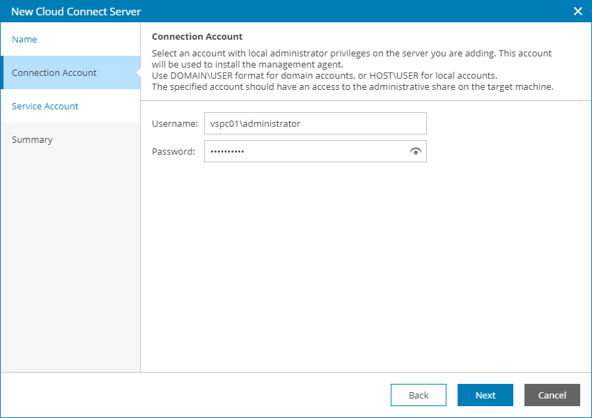

  1. At the Connection Account step of the wizard, specify credentials of a user account with local administrator privileges on the Veeam Cloud Connect server.
This account will be used to install a Veeam Service Provider Console management agent on the Veeam Cloud Connect server.
The user name must be specified in the DOMAIN\USERNAME format for domain accounts, or HOST\USERNAME format for local accounts.
Specify Connection Account Credentials

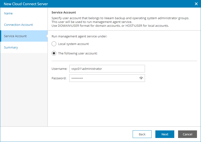

  1. At the Service Account step of the wizard, specify the account that will be used to run a management agent on the Veeam Cloud Connect server:
  • Select Local System account, if you want to run management agent under Local System account of the machine on which Veeam Cloud Connect server is installed.
  • To use a different account, select The following user account and specify credentials of a user account with Veeam Backup Administrator privileges in Veeam Backup & Replication on the Veeam Cloud Connect server and Local Administrator privileges on the machine on which Veeam Backup & Replication server is installed.
For details on Veeam Backup & Replication users, roles and privileges, see section Roles and Users of the Veeam Backup & Replication User Guide.
Specify Service Account Credentials

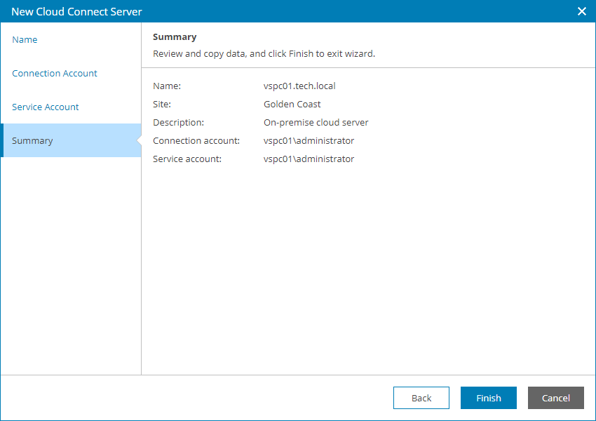

  1. At the Summary step of the wizard, review connection settings and click Finish.
Review Connection Settings
