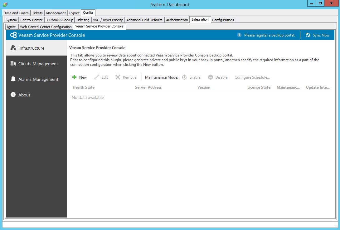

  1. Navigate to the Config > Integration > Veeam Service Provider Console tab.
ConnectWise Automate Connect Server
  1. At the top of the list, click New.

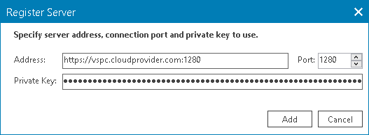

  2. In the Register Server window, specify the following settings:
  • In the Address field, specify the URL address of the Veeam Service Provider Console server.
  • In the Port field, specify the port that is used to connect to Veeam Service Provider Console server.
The port number will be added to the URL address of the Veeam Service Provider Console server automatically.
  • In the Private Key field, specify the private API key. Veeam Service Provider Console will use this key to authenticate requests from ConnectWise Automate to Veeam Service Provider Console server. For details, see Configuring API Keys.
Note that for integration with ConnectWise Automate you must generate an advanced API key for built-in plugins. Read-only access to the API key must be disabled.
  1. Click Add.
