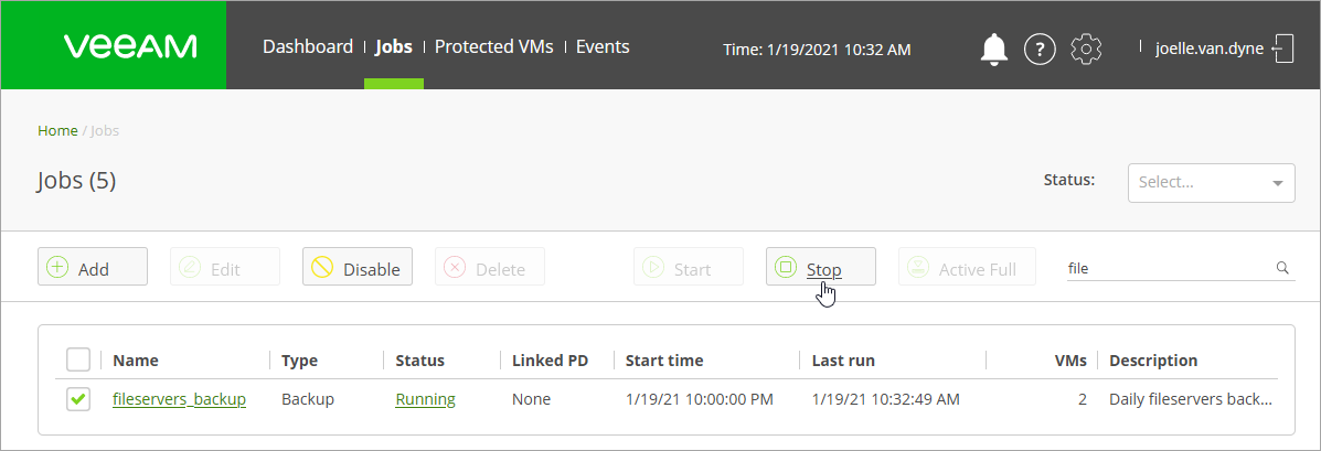

Stopping Jobs in AHV Backup Proxy Console
To stop a job in the AHV Backup Proxy web console, do the wollowing:
  1. At the main panel of the AHV Backup Proxy web console, click the Jobs tab.
  2. In the list of jobs, select a running job that you want to stop and click Stop on the toolbar.
  3. After you click Stop, AHV Backup Proxy will issue a warning that one or more VMs will have incomplete, unusable restore points.
  4. In the displayed window, click OK.
