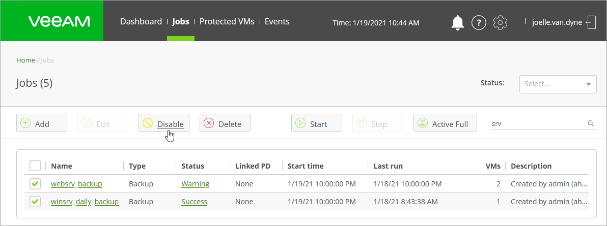

Disabling Jobs in AHV Backup Proxy Web Console
To disable a job, do the following:
- At the main panel of the AHV Backup Proxy web console, click the Jobs tab.
 - In the list of jobs, select a job and click Disable on the toolbar.
To enable a disabled job, select it in the list and click Enable on the toolbar.

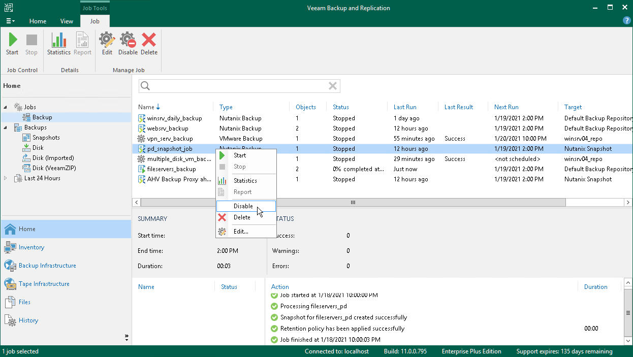

Disabling Jobs in Veeam Backup & Replication Console
- In the Veeam Backup & Replication console, open the Home view.
 - In the inventory pane, select Jobs.
 - In the working area, select the job and click Disable on the ribbon or right-click the job and select Disable.
