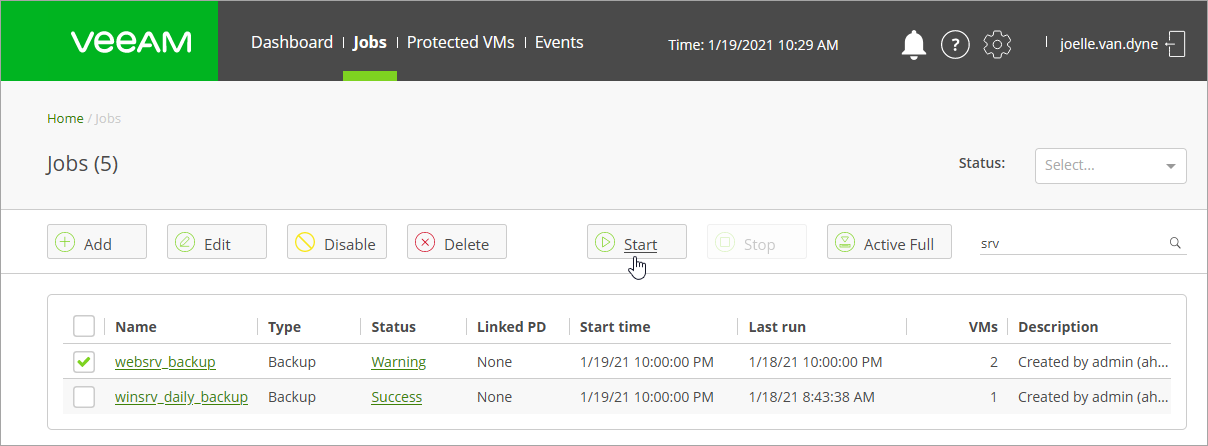

Starting Jobs in AHV Backup Proxy Web Console
To start a job in the AHV Backup Proxy web console, do the following:
- At the main panel of the AHV Backup Proxy web console, click the Jobs tab.
 - In the list of jobs, select a job and click Start on the toolbar.

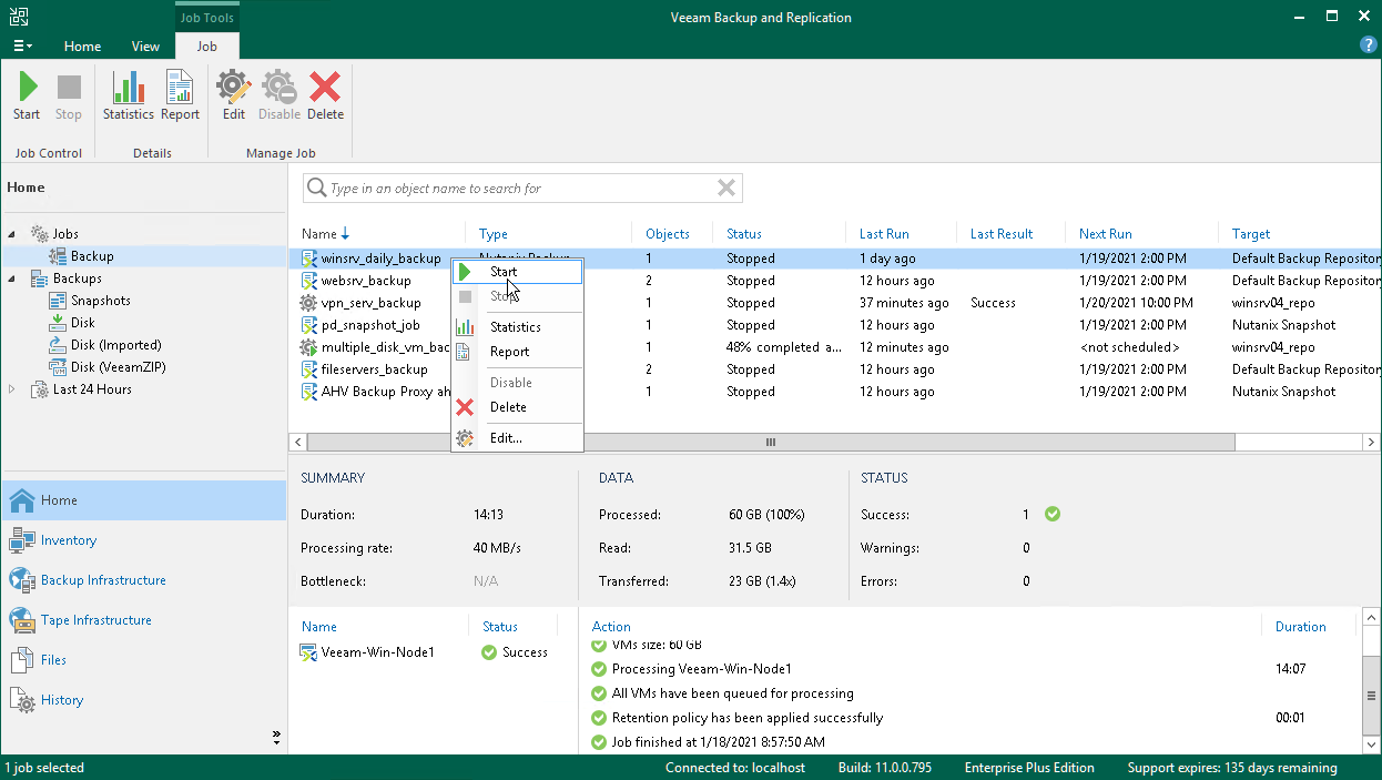

Starting Jobs in Veeam Backup & Replication Console
To start a job in the Veeam Backup & Replication console, do the following:
- Open the Home view.
 - In the inventory pane, select Jobs.
 - In the working area, select the job and click Start on the ribbon or right-click the job and select Start.
