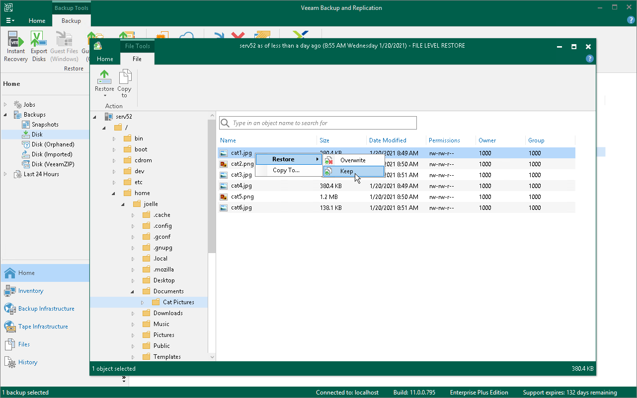

How to Restore VM Guest OS Files
To restore VM guest OS files, do the following:
- In the Veeam Backup & Replication console, open the Home view.
 - In the inventory pane, under Backups select Disk if you want to restore from a backup or Snapshot if you want to restore from a snapshot.
 - In the working area, expand the necessary backup or snapshot node, right-click the VM whose VM guest OS files you want to restore and select Restore guest files > Microsoft Windows/Linux and other OSes and follow the steps of the File Level Restore wizard. For more information, see one of the following sections of the Veeam Backup & Replication User Guide:
