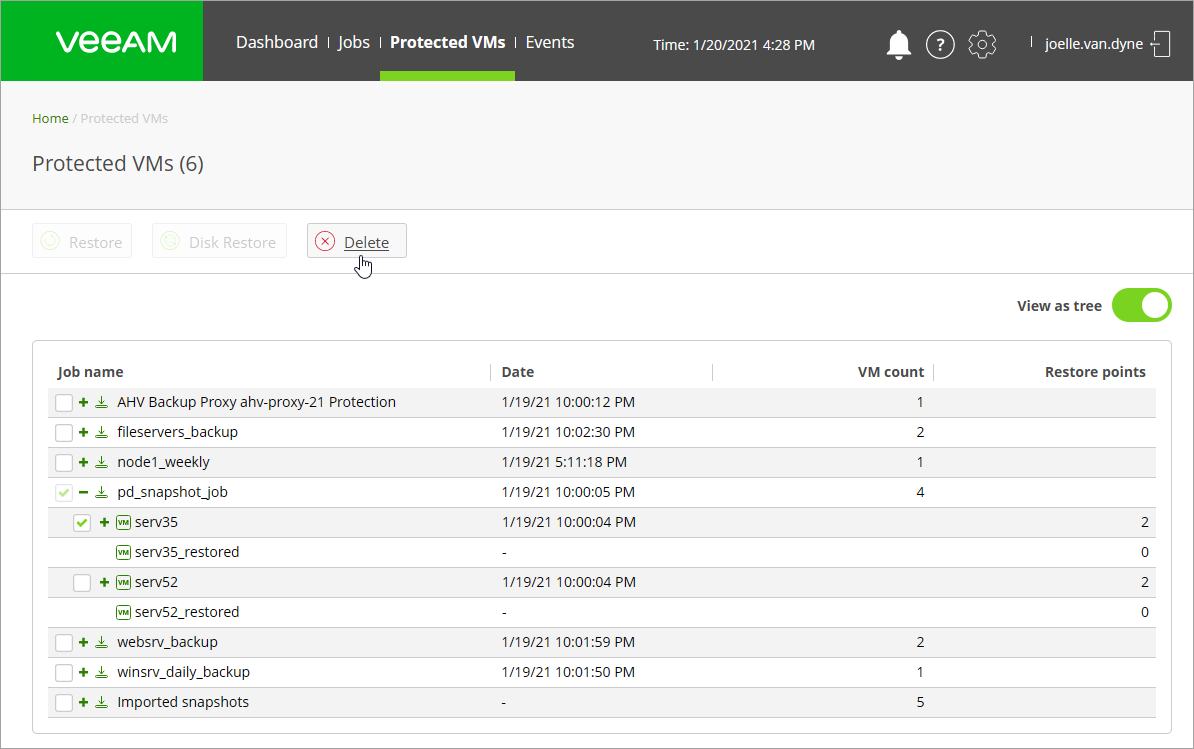

To remove a snapshot, do the following:
- At the main panel of the AHV Backup Proxy web console, click the Protected VMs tab.
 - At the right of the working area, click the View as tree toggle to enable the tree view.
 - In the Job name list, expand a necessary snapshot job.
 - Select check boxes next to snapshots that you want to delete.
 - Click Delete on the toolbar.
