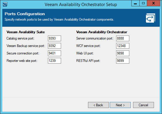

This step applies only if you have selected the Let me specify different settings check box at the Default Configuration step of the setup wizard.
At the Ports Configuration step of the wizard, customize the following ports:
- Veeam Availability Orchestrator communication ports used for collecting data from connected servers, for accessing the VAO UI through a web browser, and for connecting to the REST API functionality.
- Veeam Availability Suite ports used for communication between Veeam ONE components and Veeam Backup & Replication infrastructure components.
For the full description of ports used by VAO and their default values, see Ports.
