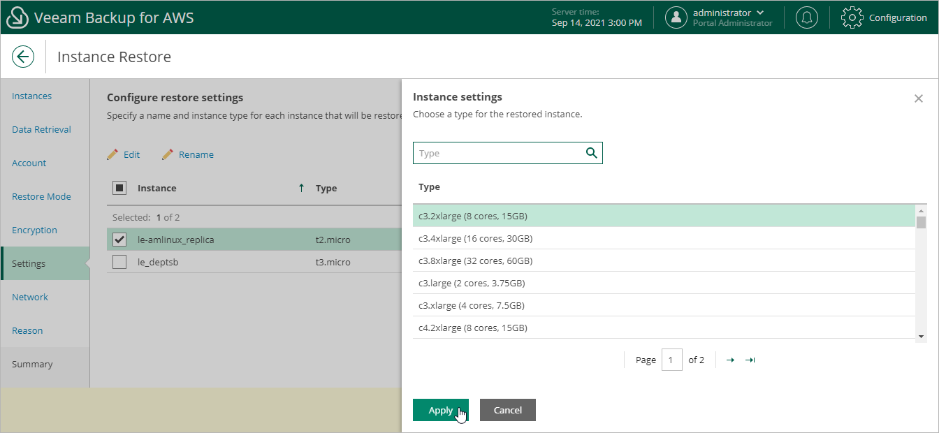

At the Settings step of the wizard, do the following for each EC2 instance added to the restore session:
- [This step applies only if you have selected the Restore to new location, or with different settings option at the Restore Mode step of the wizard] To specify a new name for the restored EC2 instance, select the source instance from the list and click Rename. In the Instance name window, specify the name and click Apply.
- [This step applies only if you have selected the Restore to new location, or with different settings option at the Restore Mode step of the wizard] To change the instance type for the restored EC2 instance, select the source instance from the list and click Edit. In the Instance type window, select the necessary instance type and click Apply. For the list of all existing instance types, see AWS Documentation.
