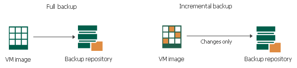

When Veeam Backup & Replication performs incremental backup, it needs to know what data blocks have changed since the previous job session. To get the list of changed data blocks, Veeam Backup & Replication uses the changed block tracking mechanism, or CBT. CBT increases the speed and efficiency of incremental backups.

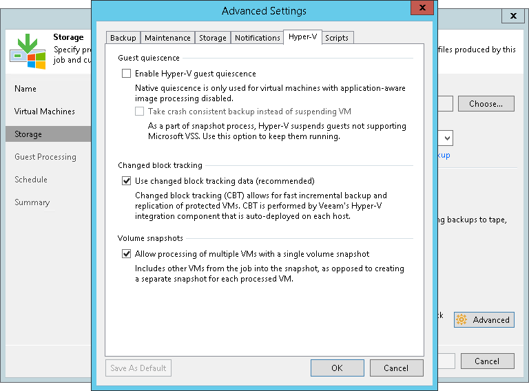

Veeam Backup & Replication enables CBT. You can disable it either at the host level or at the job level for troubleshooting purposes. Note that if you choose to run incremental jobs with CBT disabled, the backup window may increase dramatically, as Veeam Backup & Replication will read all VM data to detect what blocks have changed since the last job session.

- When Veeam Backup & Replication performs incremental backup or replication, it creates a new checkpoint for the VM that is used as a data source. Veeam Backup & Replication queries Microsoft Hyper-V to get incremental changes between the reference point created during the previous job session and checkpoint created during the current job session.
- Veeam Backup & Replication copies only changed data blocks from the created checkpoint and saves them in an incremental backup file.

In some cases, CBT data may get corrupted — as a result, Veeam Backup & Replication will fail to process VMs with changed block tracking. To reset CBT data for individual VMs or specific VHD/VHDX files, you can use the Reset-HvVmChangeTracking PowerShell cmdlet. For more information, see the Veeam PowerShell Reference.
Keep in mind that CBT data is reset when you perform product upgrade. When you run a backup job for the first time after upgrade, Veeam Backup & Replication will not use changed block tracking. Instead, it will scan the VM image to learn what data blocks have changed.
