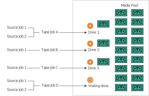

Processing Tape Jobs Simultaneously
To enable this mode, select the Enable parallel processing for tape jobs using this media pool check box in optional media pool settings. If this mode is enabled in media pool settings, for machine backup to tape jobs you can limit the number of drives the job can use, as described in Specify Archiving Options.
This option is available for backup to tape and file to tape jobs.
For example:
- You set the maximum number of drives to three.
- Four tape jobs start at the same time.
The tape jobs start, and jobs A, B and C occupy three drives to write data to tape. Tape job D is queued and waits. When one of the jobs finishes and releases its drive, tape job D takes the drive and starts writing data.

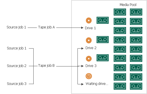

Processing Backup Chains Simultaneously
To enable this mode, select the Enable parallel processing for tape jobs using this media pool and Enable parallel processing of backup chains within a single job check boxes in optional media pool settings.
This option is available for backup to tape jobs only.
For example:
- Tape job A has one source job; tape job B has three source jobs. Both tape jobs start at the same time.
Tape job A occupies drive 1. Tape job B occupies two other available drives and processes two source jobs. Tape job A finishes and releases drive 1, the third source job from tape job B occupies drive 1.
If a source job produces multiple per-machine backups, the media pool processes several per-machine backup chains simultaneously. For more information about per-machine backup files, see Per-Machine Backup Files.

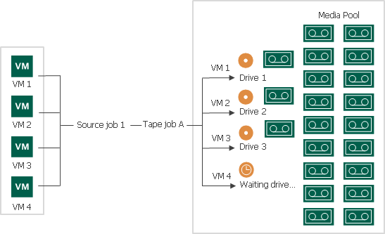

For example:
- Tape job A has one source job, the source job processes four VMs.
Tape job A starts and occupies all three available drives. It writes each separate VM of the source job by a separate drive. After tape job A finishes writing one of the current VMs and releases one of the three available drives, it occupies this drive with writing VM4. In other words, if a job with per-machine chains is configured to process more VMs than there are drives available, it occupies the entire media pool.
The order in which VMs are queued for processing is defined by the order of VMs within each source job, by the order of source jobs within each tape job and the schedule configured for running tape jobs.
