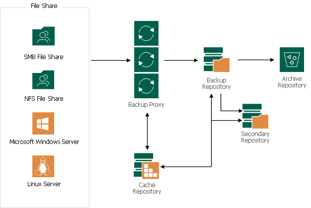

File share backup jobs in Veeam Backup & Replication can read data from the following sources:
- SMB (CIFS) path
- NFS path
- Path to the storage snapshot folder
- VSS snapshot
Note |
Mind the following limitations:
To learn how to add NAS file shares to the backup infrastructure, see Adding File Share.
You can assign the role of a backup proxy to any Windows-managed server added to your Veeam Backup & Replication infrastructure. By default, this role is assigned to the backup server. But this option is sufficient only for small installations where all components are located in the same network segment. For larger installations with larger workload, assign the role of a backup proxy to a dedicated server, as described in Adding Backup Proxy. After that, choose this backup proxy to process the backup traffic from file shares, as described in Adding NFS File Share and Adding SMB File Share.
To optimize performance of several concurrent tasks, you can use several backup proxies. In this case, Veeam Backup & Replication will distribute the backup or restore workload between available backup proxies on per-task basis, taking into account proxy connectivity and their current load. You can deploy backup proxies in the primary site or in remote sites. Mind that using a remote backup proxy may reduce backup performance and is not recommended. To minimize the network load during backup, locate the backup proxy closer to the source file share in the computer network: at the best they should be one hop away from each other.
You can assign the role of a cache repository to a simple backup repository added to the Veeam Backup & Replication infrastructure. To assign this role, select the backup repository as a cache repository, as described in Specify File Share Processing Settings.
To minimize the network load during backup, locate the cache repository closer to the backup proxy in the computer network: at the best, they should be located on one machine.

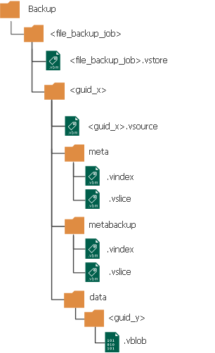

Data Structure in Backup, Archive and Secondary Repositories
Folder/File | Description | |||||
Backup |
| Folder in the repository that is dedicated to store backups. |
| <file_backup_job> |
| Folder that contains all data backed up by a specific file share backup job. Data for each job will be placed to its own directory. |
| <file_backup_job>.vstore |
| XML metadata file that describes the entire backup file for a specific file share backup job. |
| <guid_x> |
| Folder that contains all data for a single source. Data for each source will be placed to its own directory. |
| <guid_x>.vsource |
| XML metadata file that describes the single source object. |
| meta |
| Folder with binary metadata files that describe the content of the backup. If backup files are stored on a scale-out backup repository, this folder on each performance extent contains metadata for data stored on the same extent of the scale-out backup repository. For more information, see Scale-Out Repository as NAS Backup Repository. |
| .vindex |
| Binary metadata that describes backup files (names and versions). |
| .vslice |
| Binary metadata that describes allocation of data in VBLOB backup files. |
| metabackup |
| If backup files are stored on a scale-out backup repository, this folder on each performance extent contains replica of metadata stored on other extents of the scale-out backup repository. For more information, see Scale-Out Repository as NAS Backup Repository. |
| data |
| Folder with binary data. |
| <guid_y> |
| 1 Gb basket that stores VBLOB backup files. |
| .vblob | By default, a classic 64 Mb file that stores data from the file share backup. If necessary, you can convert NAS backup data files into the single file basket format recommended for storing data on HPE StoreOnce storage appliances. For more information, see description of the Convert-VBRNASBackupStorageFormat cmdlet in the Veeam PowerShell Reference. |
