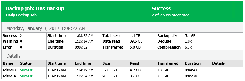

Veeam Backup & Replication displays the following counters in reports:
- The Success, Warning and Error counters show how many workloads were processed with the Success, Warning and Error statuses.
- The Start time and End time counters show when the job started and completed.
- The Duration counter shows time from the job start till the current moment or job end.
- The Total size counter shows provisioned size (the maximum configured size) of all workload disks in the job.
- The Data read counter shows the amount of data read from the volume before compression and deduplication. The value of this counter is typically lower than the value of the Total size counter. Veeam Backup & Replication reads only data blocks that have changed since the last job session, processes and copies these data blocks to the target.
- The Transferred counter shows the amount of data transferred from the source side to the target side after applying compression and source-side deduplication. This counter does not directly indicate the size of the resulting files. Depending on the backup infrastructure and job settings, Veeam Backup & Replication can perform additional activities with data: perform target-side deduplication, decompress data prior to writing the file to disk and so on. The activities can impact the size of the resulting file.
- The Backup size counter shows the resulting backup file size.
- The Dedupe counter shows the deduplication level.
- The Compression counter shows the compression level.
In the Details section, you can see similar counters for each workload processed by the job.
