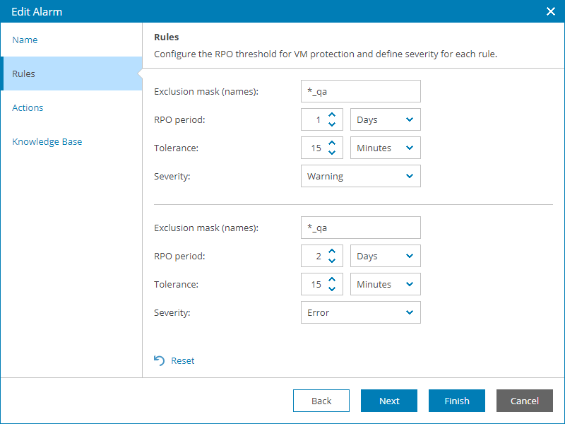

Step 2. Specify Alarm Rules
At the Rules step of the wizard, specify conditions according to which the alarm must be triggered. Options available for alarm rules vary for different alarms. Depending on the alarm type, you may need to modify alarm thresholds, alarm tolerance, alarm severity and so on.
To reset alarm rules to default settings, click Reset.
To include jobs in or exclude jobs from the alarm detection, you can configure filters:
- In the Job name field, specify job names and/or masks for jobs that you want to include in the alarm detection. Separate multiple job names with semicolons and without spaces.
To trigger alarms for specific jobs, specify the names of all jobs. For example, Job_1;Job2;Job3. Veeam Service Provider Console will trigger alarms only for specified jobs.
To trigger alarms for jobs with similar names, specify the job name with ‘*’ (asterisk) which stands for zero or more characters. For example, Job*. Veeam Service Provider Console will trigger alarms for Job_1, Job2, Job3.
To trigger alarms for jobs whose names differ by only 1 character, specify the job name with '?' which stands for one character. For example, Job?. Veeam Service Provider Console will trigger alarms for Job2 and Job3.
- In the Exclusion mask field, specify names and/or masks for jobs, VMs or computers that you want to exclude from the alarm detection. Separate multiple names with semicolons and without spaces.
To disable alarms for specific jobs, VMs or computers, specify the names of all items. For example, Job_1;Job2;Job3. Veeam Service Provider Console will disable alarms for specified jobs.
To disable alarms for jobs, VMs or computers with similar names, specify the name with ‘*’ (asterisk) which stands for zero or more characters. For example, Job*. Veeam Service Provider Console will disable alarms for Job_1, Job2, Job3.
To disable alarms for jobs, VMs or computers whose names differ by only 1 character, specify the name with '?' which stands for one character. For example, Job?. Veeam Service Provider Console will disable alarms for Job2 and Job3.
- In the Suppress after field, specify how many times alarm can be triggered. After the specified number of triggered alarms is exceeded, the alarm will not trigger until you manually resolve the already triggered alarms.
To disable the suppressing and receive information on all triggered alarms, set the value to 0.
Note: |
Before reconfiguring filters for alarms that have already been triggered, you must manually resolve these alarms. Otherwise, new alarms will be triggered according to the old settings. |

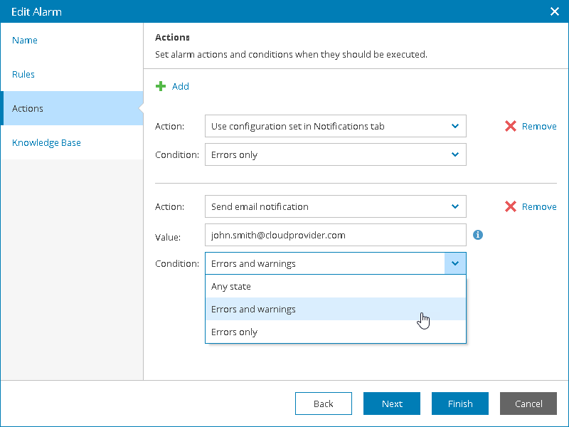

Step 3. Specify Alarm Response Actions
At the Actions step of the wizard, specify actions that must be performed when a new alarm is triggered, or when the status of an existing alarm changes.
Veeam Service Provider Console supports three types of response actions:
- You can send notifications as specified in notification settings.
Depending on the notification settings, alarm notifications are sent once a day or each time when a new alarm is triggered, or when the status of an existing alarm changes. This response action is called Use configuration set in Notifications tab. For details on notification settings, see Configuring Notification Frequency Settings.
- You can send an email notification at a specified email address.
- You can run a custom script.
You can modify the default alarm response action, or add new actions.
Sending Alarm Notifications by Email
You can add an alarm action that will send an email notification when a new alarm is triggered, or when the alarm status changes:
- At the top left corner of the wizard, click Add.
- In the Action field, choose Send email notification.
- In the Value field, type an email address at which a notification must be sent.
You can specify multiple email addresses separated with commas (,) or semicolons.
Tip: |
To send a notification to multiple users, you can use the following variables:
Veeam Service Provider Console sends an alarm notification only to owners of an object for which an alarm is triggered. To receive a notification, the user must configure an email address in the user profile. For details, see Filling User Profile. |
- In the Condition field, choose an alarm state that must trigger the response action:
- Any state — select this option if a notification must be sent every time when the alarm status changes to Error, Warning or Info, or when a new alarm with one of these statuses is triggered.
- Errors and warnings — select this option if a notification must be sent every time when the alarm status changes to Error or Warning, or when a new alarm with one of these statuses is triggered.
- Errors only — select this option if a notification must be sent every time when the alarm status changes to Error, or when a new alarm with this status is triggered.
Running Custom Script
You can add an alarm action that will run a custom script when a new alarm is triggered, or when the alarm status changes. This can be a BAT, CMD, EXE or PS1 script.
By running a script, you can automate routine tasks that are normally performed when specific alarms fire. For example, if a critical system is affected, you may need to immediately open a ticket with the in-house support or perform actions that will eliminate the problem.
- In the Action field, choose Execute script.
- In the Value field, type a path to the script file.
The script must reside on the machine where Veeam Service Provider Console is installed. If you used a distributed deployment scenario, place the script on the machine where the Veeam Service Provider Console Server component runs.
You can also provide the following variables separated by spaces: %AlarmName%, %NewState%, %Time%, %ObjectName%.
- Any state — select this option if the script must run every time when the alarm status changes to Error, Warning or Info, or when a new alarm with one of these statuses is triggered.
- Errors and warnings — select this option if the script must run every time when the alarm status changes to Error or Warning, or when a new alarm with one of these statuses is triggered.
- Errors only — select this option if the script must run every time when the alarm status changes to Error, or when a new alarm with this status is triggered.
