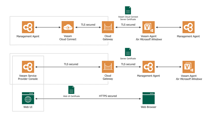

Veeam Service Provider Console requires security certificates installed on the following components:
- Veeam Service Provider Console server. This certificate is used to establish secure connection with Veeam Service Provider Console management agents installed on managed Veeam Backup & Replication servers and computers running Veeam backup agents.
By default, this certificate is installed in the Veeam Service Provider Console Setup wizard. You can change Veeam Service Provider Console server certificate in Veeam Service Provider Console. For details, see Changing Veeam Service Provider Console Server Certificate.
- Veeam Service Provider Console Web UI. This certificate is used to establish secure connection with client applications, such as web browsers or REST API clients.
By default, this certificate is installed in the Veeam Service Provider Console Setup wizard. You can change Veeam Service Provider Console Web UI certificate in Veeam Service Provider Console. For details, see Changing Veeam Service Provider Console Web UI Certificate.
- Veeam Cloud Connect server. This certificate is used to to establish secure connection with managed Veeam Backup & Replication servers and Veeam Backup Agents.
This certificate is installed in the Veeam Cloud Connect Manage Certificate wizard. For details on installing and managing Veeam Cloud Connect certificate, see section Managing TLS Certificates of the Veeam Cloud Connect Guide.

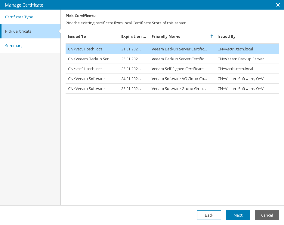

- At the top of the list, click Install > Server.
- In the Manage Certificate window, select one of the following options:
- Select certificate from the Certificate Store
With this option selected, you can choose a certificate from the Certificate Store of Veeam Service Provider Console server. The certificate must be installed in the Local Computer\Personal certificate store.
At the Pick Certificate step, select a certificate that you want to install and click Next.
- Generate new certificate (not recommended)
With this option selected, you can generate a new self-signed certificate. At the Generate Certificate step, specify friendly name for a certificate that you want to install and click Next.
- Review the certificate settings and click Finish.

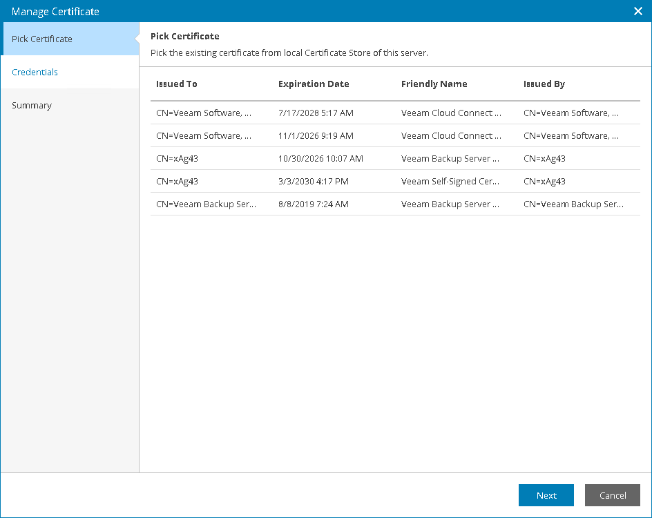

- At the top of the list, click Install > Web UI.
The Manage Certificate window will open.
- At the Pick Certificate step, select a certificate that you want to install and click Next.
- At the Credentials step, specify credentials of a local administrator of a machine on which Veeam Service Provider Console Web UI runs.
- At the Summary step, review the certificate settings and click Finish.
- Refresh the Veeam Service Provider Console portal page.
