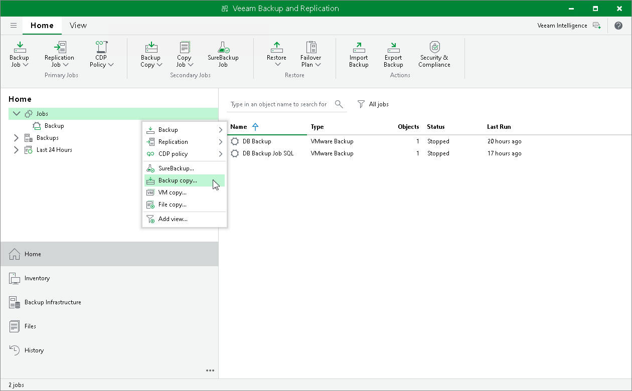

  1. Open the Home view.
  2. In the inventory pane, right-click Jobs and select Backup Copy to launch the New Backup Copy Job wizard.

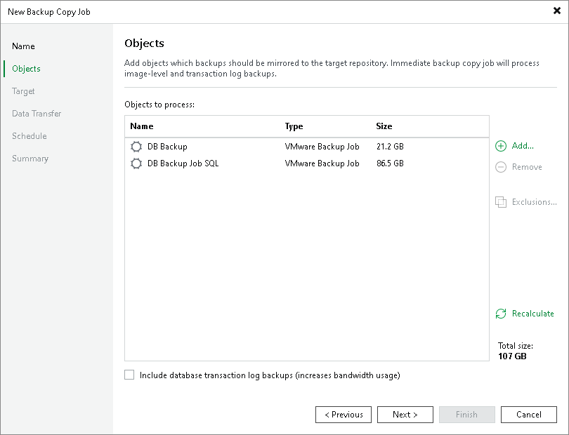

  4. At the Objects step of the wizard, click Add and select backup jobs that you want to copy.
    Choose VMs to Copy

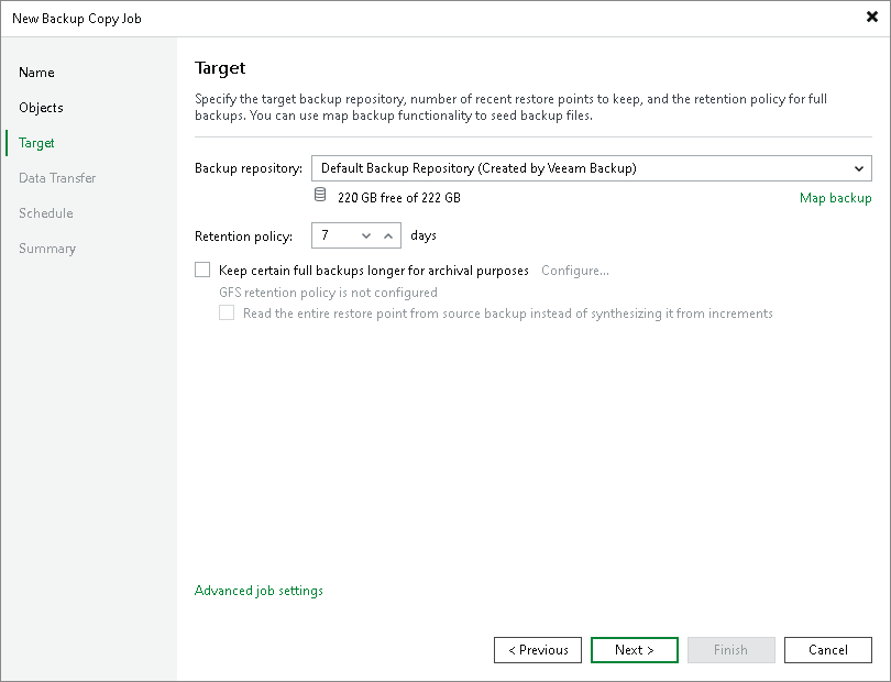

  5. At the Target step of the wizard, select the backup repository where you want to store the backup copy. For other settings, keep the default values.
    Choose Backup Copy Destination
